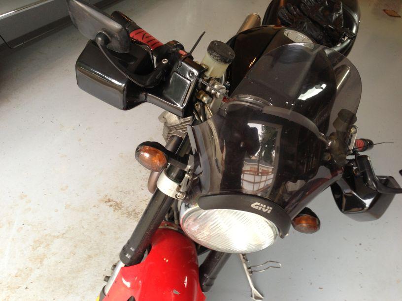

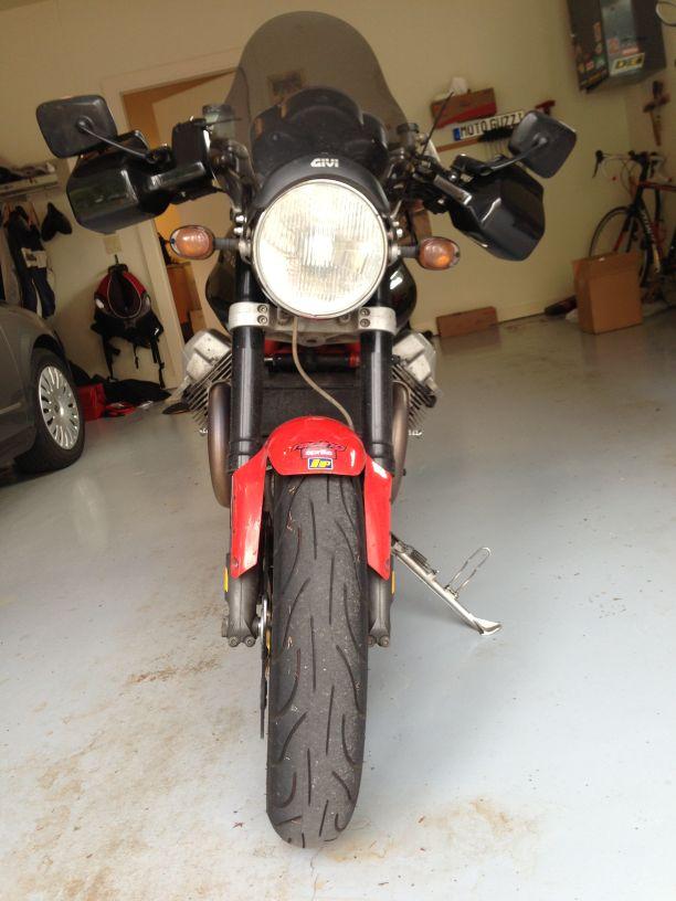

I fitted some hand guards made for a BMW R 100GS to my V11.  The goal was to keep my hands warm here in the winter.  It was an easy job, just had to get longer bolts and some spacers.  I used zip ties for additional bracing.  They make a lot of difference and I can wear my summer gloves when it is above 45 degrees F now.
See attached images if interested.
