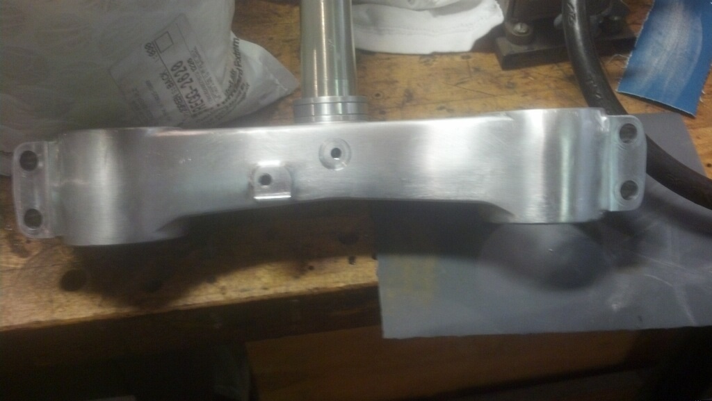

sp838 Posted February 26, 2014 Author Posted February 26, 2014 Gods willing, the front end swap is happening this Saturday! *knocking on wood, fingers crossed* Removed all the crap off the front end (headlight, gauges, ignition switch, brake lines) and the master cylinder off the handle bars. Got the top clamp off and back on, just for practice, and also because tomorrow I will grind off the tabs for the steering lock as well as all the rust, and will patch paint everything that needs it, provided my paint guy finally mixes me up the color. Docc, the part number for my top triple clamp is 01.49.31.00, as shown in the last pic below. Apparently it's from a Sport 1100IE. Saturday is the big day. I will post a recap of my successes and failures, hopefully more of the former than the latter. Here are some high res pics:

docc Posted April 9, 2014 Posted April 9, 2014 sp838, sorry the forum dropped the last couple images from your gallery. Would you mind reposting them? Especially the pic of your upper clamp on the bike - bellissimo!
