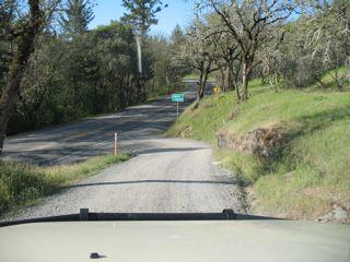

Goosed Again Posted April 25, 2013 Author Posted April 25, 2013 Here's some shots of the bike (2000 Sport) as well as the gravel road just before the highway, definitely one to be traveled cautiously! And some things I'm looking for in case anyone has spare parts hanging around collecting dust: Front fender has a couple of cracks Oil cooler is zip tied, works but brackets with bushings and screws would be nice. Shop stand for the rear end. Tool kit for under seat. Bar end weights Gonna be out of town for a couple of months, worse comes to worse I can get these from MG when I return.
