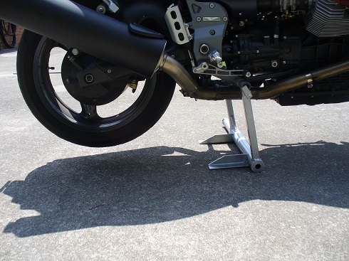

sctt2525 Posted June 3, 2015 Posted June 3, 2015 Built this one. Uses 18mm sockets on the porkchop nuts. Spring loaded keepers keep the sockets in place. 1
