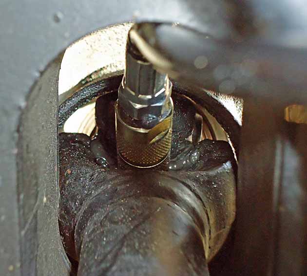

docc Posted August 7, 2013 Posted August 7, 2013 I had to cut the point off the needle and de-burr it, but finally got some confidence that a little lube made it in.

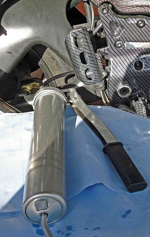

Camn Posted August 7, 2013 Posted August 7, 2013 My mistake was two years ago, that I had not read anywhere that it's not possible. I greased also the "difficult gease nipple" and read only afterwards, that it can't be done without dismantling half the bike. Beginners luck. Standard grease gun. Of couse it is not easy to get the head of the greasing pipe onto the nipple and you need to force it out with a screwdriver. PS.(added later) Maybe this is possible only because the rear shock is Öhlins, it has a longer stroke than the others = more space for the grease gun.
