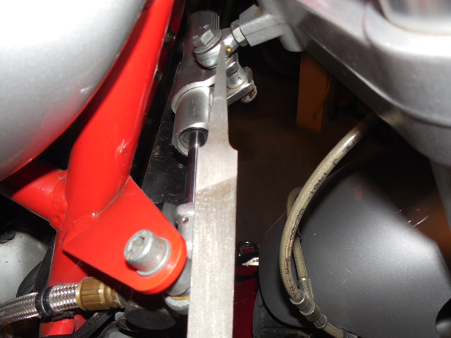

rex007can Posted September 4, 2013 Posted September 4, 2013 The screw/hoop that attaches the damper to the tripple tree broke yesterday. Luckily there was just enough left sticking out that I was able to unscrew it with pliers. So anyone know ehere I could mabe get a replacement? regular screw with a hoop at the end that attaches to the middle of the damper. While I'm at it, does any supplier maybe have a rebuild kit for those? Mine is starting to get a little "crunchy", maybe I should give it some TLC before putting it back on. Thanks.
docc Posted September 4, 2013 Posted September 4, 2013 By the "screw/hoop" I'm thinking you refer to the Heim joint. It should be available in its metric dimensions. And you mean rebuilding the steering damper itself? Not sure the year of your Sport, but most have Bitubo dampers which are leak prone. I replaced mine with a Japanese built Shindy that has worked very well for less money than the Bitubo replacement. Not sure about a rebuild.
rex007can Posted September 5, 2013 Author Posted September 5, 2013 It's a 2001 V11 sport. Not exactly the heim joint, there's no swivel in it that I could see. I did see that I could easily get a generic and relatively inexpensive replacement online. I'll probably go that way instead of trying to fix it. Thanks.
docc Posted September 5, 2013 Posted September 5, 2013 This clamp around the damper? Or this piece attaching the damper to the triple clamp?
rex007can Posted September 17, 2013 Author Posted September 17, 2013 Just the piece attaching the damper to the triple tree. The clamp itself looks fine
docc Posted September 17, 2013 Posted September 17, 2013 It is the Heim Joint: 8mm, right hand thread, male Measurements: 55mm overall length, 8mm opening, with 25mm length of threaded 8mm x 1.25 shaft Amazon - 4 for $25 Ebay LH/RH set $14.99 When I took delivery of my replacement Shindy, it came with a new Heim joints. So, if your Bitubo is "crunchy" your replacement will likely have new joints.
rex007can Posted September 18, 2013 Author Posted September 18, 2013 Thank-you. Learning what things are actually called makes them so much easier to find...
