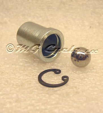

moto fugazzi Posted September 8, 2013 Share Posted September 8, 2013 I had the tough shifting problem shortly after buying my 2001 V11S. Greasing the linkage took care of that. Also, there is a ball check valve that resides in the base of the oil breather hose at the engine. Make sure it's not seized. I bought mine from MG Cycles: Ken EDIT: 10-28-2013: A deeper look revealed no check valve. Apparently, this was "done away with" on the V11. More discussion on this thread: Bell Housing Leak Link to comment Share on other sites More sharing options...
thevoodoochild Posted September 8, 2013 Author Share Posted September 8, 2013 I had the tough shifting problem shortly after buying my 2001 V11S. Greasing the linkage took care of that. Also, there is a ball check valve that resides in the base of the oil breather hose at the engine. Make sure it's not seized. I bought mine from MG Cycles: Ken ill get one tonight... just in case mine seized....its just $13....thanks Link to comment Share on other sites More sharing options...
