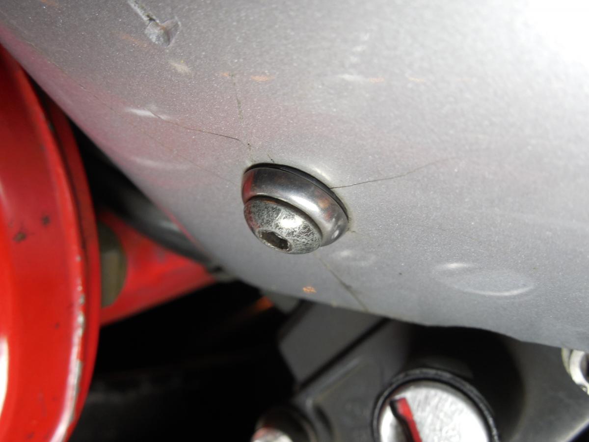

docc Posted October 22, 2013 Posted October 22, 2013 On my busted up side covers I use stainless finish washers to spread the load. Looks like they would also work on the fender:

AndyH Posted October 22, 2013 Posted October 22, 2013 On 10/22/2013 at 3:32 PM, rossi46 said: Hi decided to fit a fender extender today, been riding in some serious rain recently, all was well except for those 3 stupid tiny bolts and the rubber 'captive nut' thingy that join the two halves together! having destroyed 2 of them is there a better alternative ? thanks Know what you mean, really fiddly, but if you don't use the 'top hat', the alternative is a cracked mudguard. I used a nylon washer to protect the plastic - a bit more give. I got replacement top hats for the mudguard from Stein Dinse, pretty quick turnaround.What fender extenda are you planning to use? I've also been looking for one to keep the crap of the engine now things have got wet here (mild and wet, kind of weird for October!) Loads of things on offer on the 'bay but for 'V11', that could just as likely be a Cali which won't do, I think.

sp838 Posted October 30, 2013 Posted October 30, 2013 I AM SO ANGRY. Took a look at my brand new front fender, which I installed less than six months ago, and it has cracks around two of the three holes where the two halves join. So craptastic! There is no possible chance it would be under any sort warranty, is there? Even if I bought it through a dealership? Gonna be doing the front end swap this winter and using a GSXR fender, but I was planning on using this on another bike. This really p*sses me off. Oh, and very nice fender extender btw.
