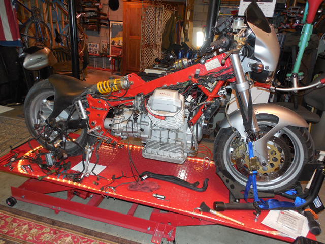

docc Posted January 18, 2014 Author Posted January 18, 2014 Admittedly, I've been putting this off. It has been necessary to devote some proper attention to the Beer Thread since, apparently, Helio-Jim only quaffs during Advent . . . My plan for February is to remove the tank and the tail section to change the vent hose and finally weld my broken left exhaust/pannier hanger. I'm hoping to do this without removing the entire rear seat sub-frame. EDIT (February 28, 2014): Had to pull off 3/4 of the wiring harness and remove the entire rear subframe to weld it safely. Sheesh - no wonder I put this off over three years!

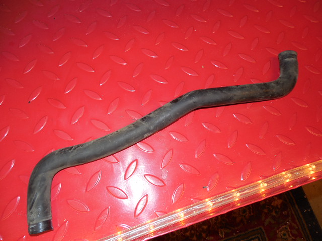

docc Posted February 20, 2014 Author Posted February 20, 2014 On the slippery slope now. Tank off, fished out the vent tube. I was hoping to find it in worse shape! I'll pick up the Ford heater hose tomorrow and post reference numbers for Gates and a detailed fitting. Meanwhile, deeper to find the wetness!

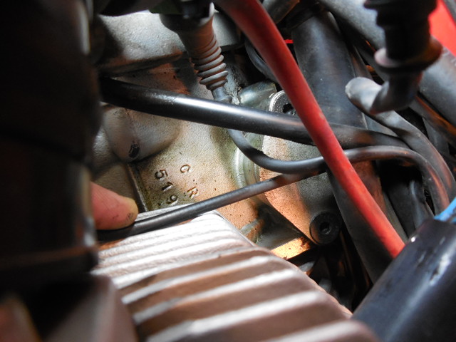

docc Posted February 20, 2014 Author Posted February 20, 2014 Pretty fresh and wet around the distributor blanking plate. Never had it off, what's under there?
docc Posted February 20, 2014 Author Posted February 20, 2014 Oh. That's what's under there: a clapped out, 89,000 mile square-section, leaky O-ring! Must it be Viton to replace?
gstallons Posted February 20, 2014 Posted February 20, 2014 No..... you should be able to match it up at a good auto parts store or industrial equipment store . When you reinstall , put a smear of silicone sealant around the flat portion of the block-off to aid in sealing .

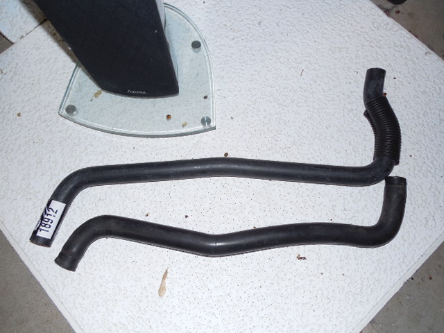

docc Posted February 21, 2014 Author Posted February 21, 2014 Gates 18912 (cross referenced from the Goodyear 63318) heater hose was about $40. Yet, my auto parts guy has no confidence it will hold up to the oil exposure. How big of a concern is that? 1
gstallons Posted February 21, 2014 Posted February 21, 2014 I can send you a pic of a heater hose that has been exposed to oil ..... It expands to about 2 Xs the diameter and gets very sticky..IDK how long this line/hose will last. 1
docc Posted February 21, 2014 Author Posted February 21, 2014 So, this whole idea that we can cut down a heater hose for the Crankcase vent return line is bunk?
gstallons Posted February 21, 2014 Posted February 21, 2014 That has been my experience.... rubber is for petroleum or coolant and sometimes both....unfortunately you need to find a hose that will work with petroleum or buy the factory ( crummy) vent hose.... the hose you have might last a year or two . 1
