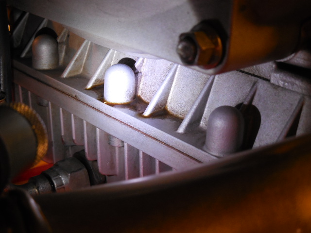

docc Posted February 28, 2014 Author Posted February 28, 2014 After replacing the breather hose (with the Moto Guzzi hose from MGcycle) and sealing the distributor cover plate, a little 44 mile ride shows no wetness anywhere. I did take the time to remove the starter and the right side inspection plug and wash out the bell housing with electronics cleaner. Time will now tell if all the wetness that looked like it was coming from the bell housing/ rear of the engine has actually been from the top of the engine. Let's hope!!
docc Posted March 15, 2014 Author Posted March 15, 2014 After a hundred miles, no weep hole leak. The top of the motor is dry. I had never noticed that the distributor block off plate is right next to the opening for the crankcase breather allowing oil to flow out of the plate and through the bell housing. It appears that sealing this plate has stopped the bell housing leak! (That said, I also replaced the breather hose, the dipstick O-ring, and the O-ring on the timing sensor.) 1
docc Posted April 21, 2014 Author Posted April 21, 2014 Sure, another hundred miles and it shows its ugly head. Every thing I fixed so far has tightened it up more and more, but something is still drizzling fresh oil out the weep hole. Now pondering whether to just ride it, put up with the nuisance, and wait for the clutch to start slipping so I can replace that and get the oil leak stopped all while the gearbox is off the engine.

moto fugazzi Posted May 9, 2014 Posted May 9, 2014 Just an update with my 2001 V11S. It was the rear main seal. The dealer will finally be done with it early next week. The first seal he ordered was the wrong size, and he swears that he ordered the right part number. That may explain why the PO had his seal replaced within the first 1,000 miles. Turns out my swing arm bearings were shot as well, and I had him do a few other things as well (shift return spring, clutch discs, wheel bearings). I'm sure the repairs will be expensive, but I've been working 6-7 days per week and certainly don't have the time to tackle this myself. Can't wait to get it back and update the ECU with Guzzidiag. I have a version from Meinolf that is supposed to make corrections for temperature so that it doesn't run lean when it gets hot. Check out his work here: http://wildguzzi.com/forum/index.php?topic=67653.0 Ken
docc Posted May 9, 2014 Author Posted May 9, 2014 Ken, Be sure to have your dealer address the other leak sources while the bike's apart: the cam plug and the two bolts. Some would say it's also a good time for a new gearbox input shaft seal and a new seal for the clutch actuation shaft. Thanks for posting your results. This remains on my "To Do" list . . .
