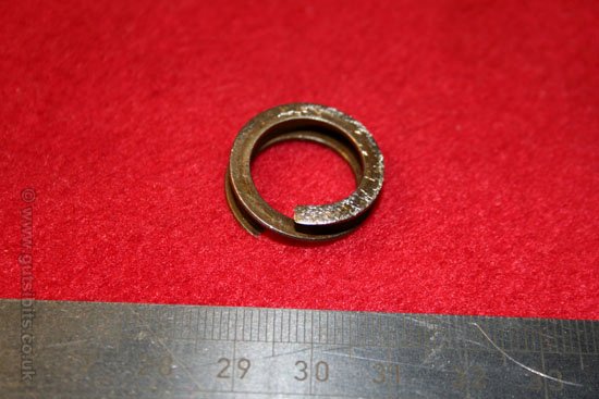

sp838 Posted November 20, 2013 Posted November 20, 2013 I am going to be torquing the head bolts, checking/adjusting valve lash, replacing rocker cover gaskets next week. I've found couple great threads here in the forum, as well as nice step by step here: http://www.geocities.ws/motoguzzi1064/GuzziFiles/V11ValvesTorque.htm What I haven't found is any mention of replacing the rocker arm springs (part number 94 32 22 15 - http://www.gutsibits.co.uk/prod_img/lrg/IMG_1634.jpg) with shims, in order to all but eliminate side to side play in the rocker arms. This is standard practice in BMW airheads, I was wondering if anyone here had any experience with this.
luhbo Posted November 20, 2013 Posted November 20, 2013 Good question. It's standard on Beemers ever since, same as the springs are standard ever since on the Guzzi Vee. I don't know anything about tolerances up there or how much the parts shrink or grow with changing temperatures, but these springs at least make sure that the rockerarms will rock, regardless whatever circumstances might come together. Imagine that for the effect you think of you'd need to take out the play between arms and base more or less completely. Hubert

sp838 Posted November 21, 2013 Author Posted November 21, 2013 From Michael Rich at Mike Rich Motorsports: "Typically shimming the rocker arms is done by custom making bronze spacers to fit--you must have .004" side clearance to allow for oil to escape and the growth of the spacer--use 630 bronze--Be sure the ends of your rocker arms a smooth." And from Charley at Zydeco Racing: "I'm not sure how much play would be removed by replacing the springs with solid spacers. I ran solid spacers on my race bike, but that was more to help with oil pressure. If you do go to solid spacers, they need .004" clearance between the rocker stand and the rocker arm.....measured at either end of the spacer. Be sure that both ends of the rocker arm are square and machined smooth, as well as the area on the rocker stands where the spacers will contact them. If they need to be cleaned up or machined, do this before measuring for your spacer which must be .004" shorter than that distance. If the oil has no where to go, very little will ever reach the rockers. If you have a lot of side to side movement, you probably need new rocker arm bushings and spindles. Also, if you have sacked springs, worn copper thrust washers (that are pushed on by the springs) and worn bushings and spindles, you can bleed off excessive amounts of oil, which will lower your overall oil pressure. If you ever change the small bolts which attach the spindles to the rocker stands, make sure they are no longer than the stock bolts or they will block off the oil coming up through the stand, which then is directed down through the center of the spindles and lubricates the rocker arms. Make sure that the rocker stands have not warped and the bosses in the heads where the rockers mount are still flat and square. Since there is no gasket there, you can bleed off a lot of oil pressure, if things don't mate well." Not a quickie job, but good to know how to do it if the interest ever arises. I plan on taking my bike to the track next season, so it's not out of the realm of possibility.
