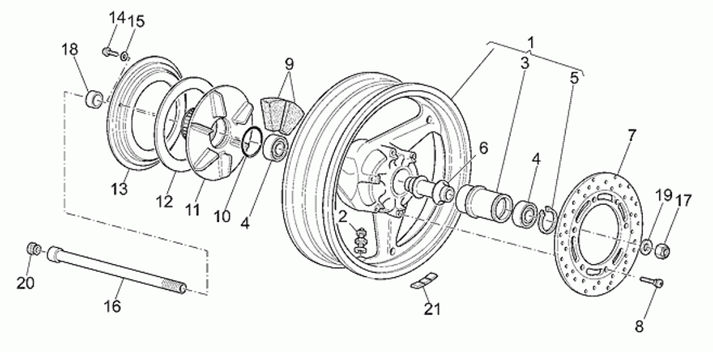

LaGrasta Posted May 11, 2024 Posted May 11, 2024 I read this thread today, looking for rear axle order: axle, nut, shim and spacer. Didn't find it. The factory manual schematic is not very good. shim, spacer goes…?
Lucky Phil Posted May 11, 2024 Posted May 11, 2024 1 hour ago, LaGrasta said: I read this thread today, looking for rear axle order: axle, nut, shim and spacer. Didn't find it. The factory manual schematic is not very good. shim, spacer goes…? Wrong manual page. Item 33 page D6 2002 manual p/n 37359005 Axle, swingarm, shim, bevel box with needle bearing, spacer, rear wheel with drive spline assy, brake hanger, swingarm washer, nut. Phil 1 1
LaGrasta Posted May 12, 2024 Posted May 12, 2024 All installed, rolling as intended! Thank you. Damn, new tires make for a brand new feeling! 1
