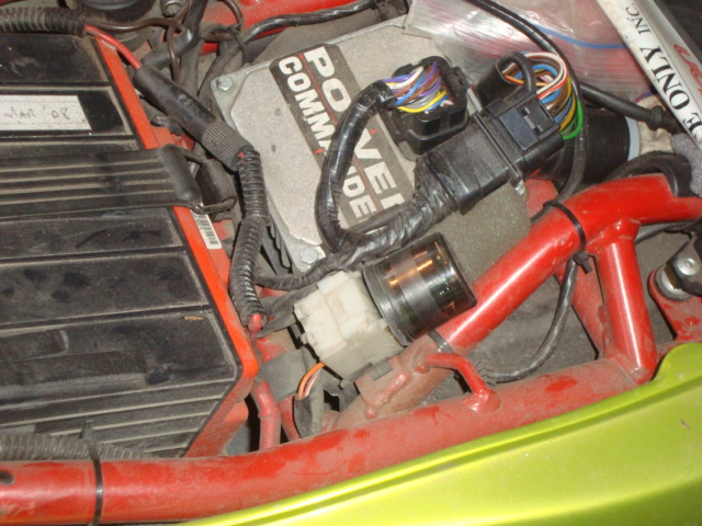

Tom M Posted April 18, 2014 Posted April 18, 2014 The flasher unit is the silver cylindrical thing next to the ECU under your seat.
Gio Posted April 18, 2014 Posted April 18, 2014 Flasher is located under the seat on the left side - just behind the battery (see pic) - I replaced mine a few years ago. Giio

nobleswood Posted April 24, 2014 Author Posted April 24, 2014 Thanks all. Ordered a replacement from Harpers today; couldn't find anything with the right plugs or the right shape to go back in. On the 2004 the units under the seat on the RHS but you have to take the seat cowling off to get to it. It has a clip on the back that holds onto a rubber mount.
