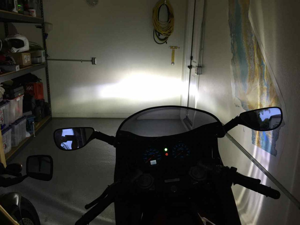

moto fugazzi Posted May 14, 2016 Posted May 14, 2016 From what I've read, the LED bulbs don't get hot. Some have complained that the headlight lens will frost over in winter, and now trucklite makes a version that has heating elements in the glass to melt snow/ice/frost from the glass. Ken P.S. Hey Scud, any chance that you can get a few pics of the beam pattern of your LED? 1

Scud Posted May 15, 2016 Posted May 15, 2016 Ken - well-timed request. I was shuffling stuff to get the dirt bike out for tomorrow. Here is the LeMans with the H4 LED from GuzziTech: For comparison, here is the Scura with stock bulb:

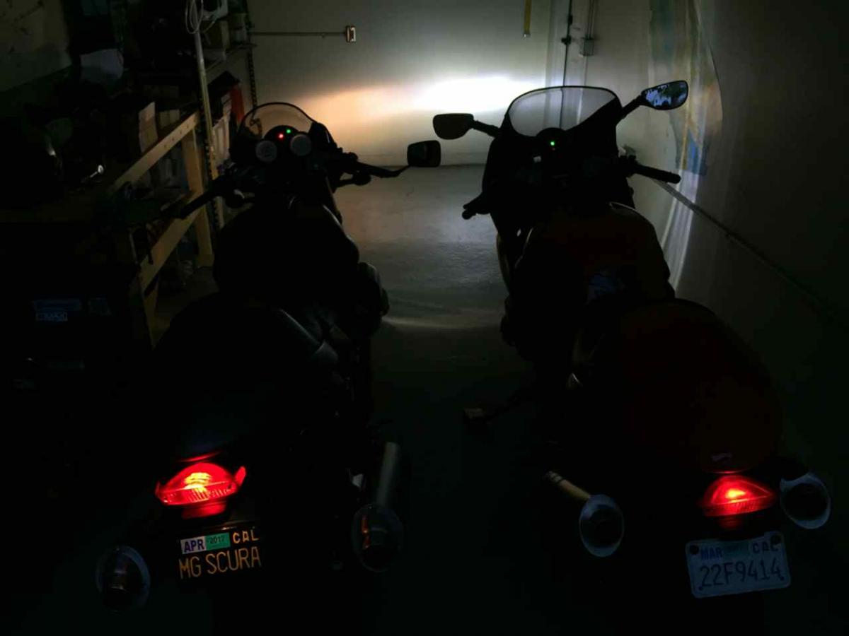

Scud Posted May 15, 2016 Posted May 15, 2016 And some side-by-side comparisons: Also note that the Scura taillight (left) is LED, while the LeMans taillight (right) is the stock incandescent. And I just noticed that the LeMans' license plate light is out... And a gratuitous picture, cuz they look better with the lights on, if you know what I mean. But, damn, the footpegs on the Scura are awfully shiny. Something must be done about that... 3
