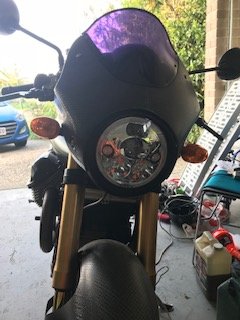

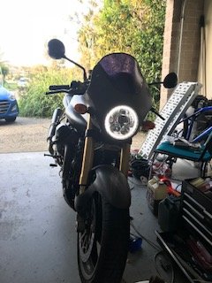

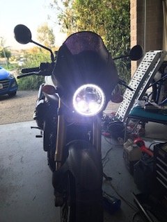

tattootim1 Posted August 6, 2019 Posted August 6, 2019 So here is a couple of pics of my new light. Its a Great White, cost $500 and was relativley painless to adapt. Had to cut out the back of the bucket and grind the little plastic tabs on the original globe front but it was plug and play and is mind blowing how good it is. I would say the JW speaker adapter kit would probably have worked with this light as well but this was half the price of the JW. Although non adaptive its amazing how good it is. Ill post more photos 2
