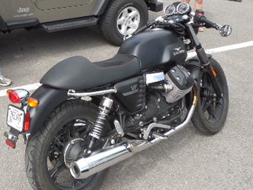

docc Posted May 15, 2014 Posted May 15, 2014 Let the tuning begin! I really like this V7! Sure, it can be improved, but isn't that why we're here? Looks like a solo saddle, lower bars with bar-end mirrors will be first up. After a brief (trade off) ride, it seems more weight forward would be good. After the bar change, I think we'll sink the triple clamps a bit and lift the rear about the same (maybe a quarter inch/ 6 mm). Good news is the boy weighs in at the likely weight of a Guzzi test rider! (Springs should be ok).
czakky Posted May 15, 2014 Posted May 15, 2014 That's not a solo saddle on his v7? I know Honda has got there hand in a "vintage/retro" model already but a new GB500.... Those of us that were too young to buy em originally we should get a chance.
docc Posted May 15, 2014 Author Posted May 15, 2014 First addition was the black suede/red stitched solo saddle from the Racer. I haven't seen any hints that Honda may try the retro thing again. I thought they got burned the last time and wouldn't be back. (Love my GB and got it pretty cheap. Sat for two years new and all the showroom dust was free!)

docc Posted May 26, 2014 Author Posted May 26, 2014 Unfortunately, flat narrow bars would not fit as the brake master cylinder/reservoir assembly extends too far inboard and fouls the top of the fork. On to the Tomaselli clip-ons!
docc Posted June 7, 2014 Author Posted June 7, 2014 Tomaselli clip-ons with CRG bar-ends. Triple clamps lowered 6mm, shocks +4mm with a nice improvement in turn-in, says he!
docc Posted June 11, 2014 Author Posted June 11, 2014 On 6/7/2014 at 3:11 PM, AndyH said: Nice, no detriment to handling at speed? He says it feels great. Definite improvement. I'm looking forward to snagging a spin on it maybe this weekend. On the hunt for proper rearsets now to complete the stance. The Guzzi V7 Racer pieces look nice - I wonder who is making them?
