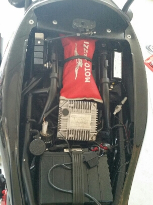

kiwijen Posted July 20, 2014 Posted July 20, 2014 Took a comparison pic of under seat. . Corsa with battery.. my cafe sport without. . Starting to think the frame had been rebuilt. . They're totally different

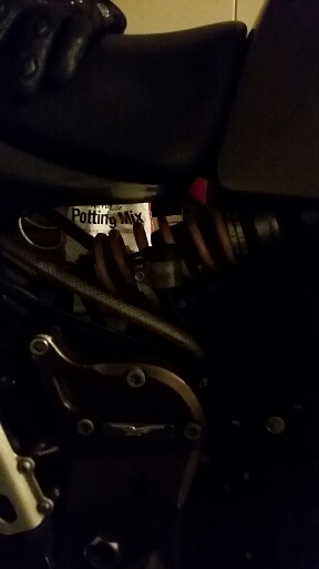

dangerous Posted July 20, 2014 Author Posted July 20, 2014 yeah... forgot about that, ok so both are 04 V11's how can or why are the sub frames so different? Jen... were is your rear brake fluid kept, it seems to be missing?
dangerous Posted July 20, 2014 Author Posted July 20, 2014 Hey grossohc, can you clarify which your bike is like? Dangerous showed us a photo above of his Le Mans Nero Corsa battery box, not the Cafe Sport bike he is working on for somebody. He says his buddy's Cafe does *not* look like the picture above, and all the battery tray mounting tabs are missing... So does your Cafe Sport look like the Nero Corsa photo or no? We're trying to figure out if somebody modified his friend's Cafe Sport. Mine is exactly the same as the nero corsa and i have a pc545 oddysey battery fitted. They are all the same (i think) Thanks! That's what I figured, and I agree that all bikes are the same... I also know that there's a used battery tray available from TLM in Netherlands. hey guys... as above I questioned the batary mounts missing but look the frame is way different note the tube each side of the tool kit, not in the cafe, note the relay mounts on there side in the cafe upright on mine, note the missing brake resovar... Im honestly thinking the sub frame is of a earler V11? of course none of this helps with the eratic backfiring.

GuzziMoto Posted July 20, 2014 Posted July 20, 2014 It looks like the one subframe has been butchered pretty good. From the pic I can't say for sure but it looks like part of the original subframe has been cut away. All V11's seem to have the same subframe. I do not know of any significant differences between older and newer. I do know that my wifes V11 is an early red frame version and its subframe looks just like the pic of your Corsa with the battery in it. I assume someone thought it would be cool to lighten up their Guzzi, so they hacked away at the subframe removing everything they thought was not needed and moved the battery to under the tank. I hope it is still structurally sound. It does appear that they also removed the safety catches that hold the seat on. That Guzzi looks to have been seriously hacked up, but it does not look like it is a different subframe so much as it looks like large parts of the original one were cut away. But you, being there in person, would be better able to assess the subframe then I looking at pictues.
dangerous Posted July 20, 2014 Author Posted July 20, 2014 the thing is GM... if its been hacked up then its been done extreamly tidely, no signs of cutting grinding and paint looks orgional the red frame thing, you say the subs the same, acepted... i know the red frames main frame is quite different up front thats why I wondered bout the sub? farking Guzzi
