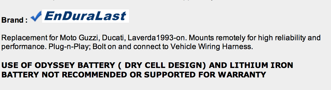

moto fugazzi Posted October 15, 2014 Posted October 15, 2014 Where did you find the info on the warning for charging? Is that from EME? I also noticed the "not recommended for use with Odyssey or Lithium Iron (yes, Iron)" batteries. I wonder if that's part of the issue with the original R/R's. They were designed for use with lead acid batteries, and quite a few of us are using Odyssey or newer technology batteries. I still had my original R/R in my bike until I decided to "upgrade" to an ESR510 2 years ago, and have had nothing but problems with them. Just a thought, and keep in mind that I have no idea about charging methods of these newer technology batteries. Hell, I was at Home Depot yesterday looking at cordless drills, and the sales person mentioned that the Makita drills required the multi chemistry chargers for their batteries. No idea what that's about. Ken 1

docc Posted October 15, 2014 Author Posted October 15, 2014 Where did you find the info on the warning for charging? Is that from EME? Yeah, it's a sticker on the invoice. A separate sticker "strongly advises" the separate ground. Where did you see the disclaimer about the Odyssey (AGM) application?
moto fugazzi Posted October 16, 2014 Posted October 16, 2014 Where did you see the disclaimer about the Odyssey (AGM) application? It's right on the website in the description. http://www.euromotoelectrics.com/product-p/edlguz-voltrectoe.htm

docc Posted October 16, 2014 Author Posted October 16, 2014 Where did you see the disclaimer about the Odyssey (AGM) application? It's right on the website in the description. http://www.euromotoelectrics.com/product-p/edlguz-voltrectoe.htm I don't see the V11 series listed for that application. This is the specific unit on my Sport EDL-450 from EME. I do see the Odyssey disclaimer there as well. And no detailed applications chart at all. Technical specifications do claim 14.2 Volt setting which is perfect for the AGM. I'll try to ignore their also listing the lithium "iron" as not recommended, but what is it about the AGM that would not be compatible with these regulators?
