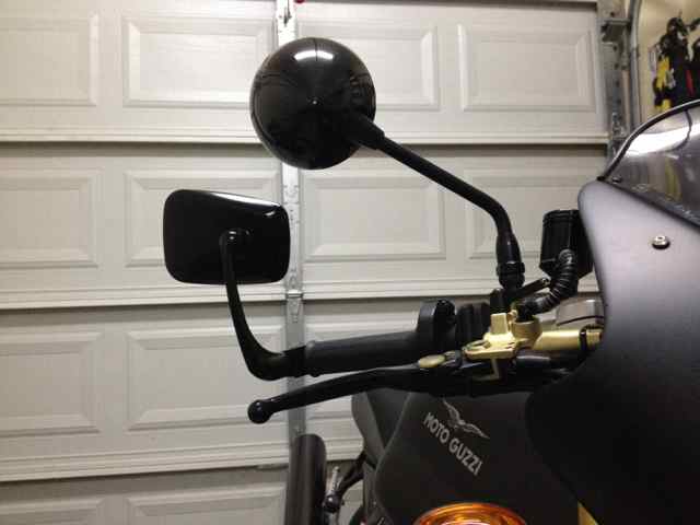

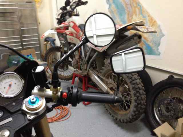

Scud Posted November 21, 2014 Posted November 21, 2014 I had the Napoleon style on my Ducati Sport 1000 (came stock) and on my BMW R100CS (added) - liked them a lot for visibility, looks, and adjustability. I was just trying to fit a pair on the Scura. However, when I removed the bar-end weights, I found that the inside of the bars are threaded and that the rubber bushing of the Napoleons would not fit. Even if it did fit, compressing a rubber bushing into threads would seem to make it very difficult to remove later. Has someone else solved this puzzle? Maybe the threads are some kind of insert that can be removed - if so, I'd appreciate a tip. 1

Scud Posted December 4, 2014 Posted December 4, 2014 Got the Napoleons mounted. I used the wire wheel on my bench grinder to shave the inner bushing down to size to fit in the bars - also had to grind down the flange on the compression nut to get it to fit. Here are two pictures with both mirrors for comparison purposes. Seeing it with all four mirrors on made me think of this...
