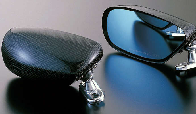

Jan Hubert Posted October 25, 2015 Author Posted October 25, 2015 Still nothing found to replace the old ones. I agree with Docc: bar end mirrors for my 1100 sport are a "no-go". So i'll have to find something else: Anyone experienced with these? http://www.moto-works.jp/products/rr-mirrors.html
docc Posted October 26, 2015 Posted October 26, 2015 Those look like very nice pieces! I am not clear if the prices are for one each or a pair?
Jan Hubert Posted March 16, 2016 Author Posted March 16, 2016 I decided not to buy these carbon pieces from Japan and keep the original parts. Approximate 330 euro's might be worth it but it's to much for me now. Therefore i experimented with the original mirrors. The problem is that most plastics do expand over the years resulting in less grip on the metal knob of the stem. Fixing this is not easy, since you need adjusting mirrors over at least two axis. Besides, there is not much space nor material to attach whatever. Find enclosed some pictures from the final solution, costing me less than 20 euro's. That rubber ring is needed for three reasons: [a] to be sure the strap (Wolfcraft #2917.000) will be pressed to the most outer diametre and it will press to the plastic housing only, not to the metal knob of the stem (that wouldn't work as you can imagine) and [c] adds friction in the rotating movement. As you can see, the rubber slipcover still fits perfectly around the new situation. Please notice that the mirrors are in an upside-down position. This is to have them horizontal on the bike. I think its looks great and fits to the low profile of my bike. All feels solid now and readjusting my mirrors in a usable postion is acceptable. If you dont like this upside-down position, the stem needs some minor bending by forcing it the hard way (eg in a vice). Swapping left to right vice versa doesn't work btw, things get only worse. You'll find bigger pictures in my folder in the gallery.
