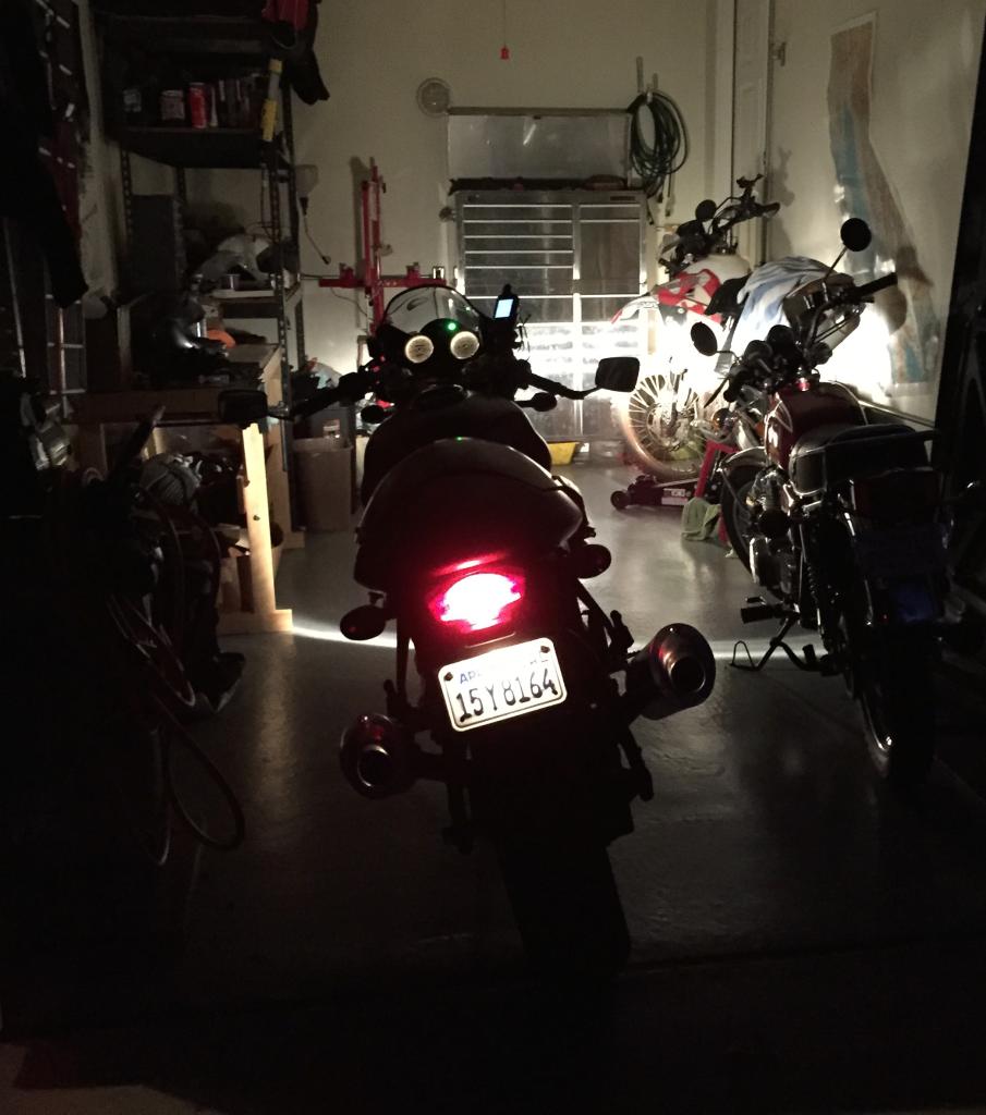

Scud Posted January 31, 2015 Author Posted January 31, 2015 Here's the night-test of the black vinyl reflective tape. Photo taken with flash from phone. The tape is almost unnoticeable during the day (except of course for the infill on the fork bottoms, which IMO looks kind of cool). In addition to the forks, I put two strips on the lower frame and three on the swingarm, and cut out some pieces to fit the sides of the license plate light mount on the fender and wrap the raised strip that goes around the plate light. Safety first. Where are the rear brake lever and master cylinder guard? I can't see them.

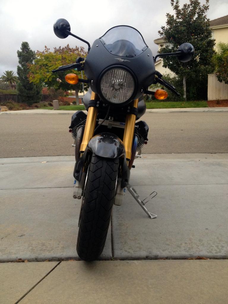

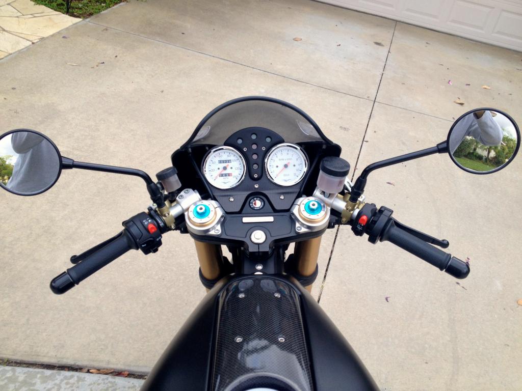

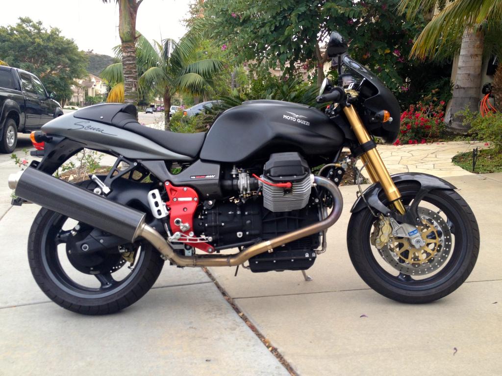

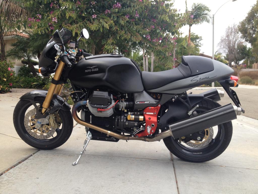

Scud Posted February 2, 2015 Author Posted February 2, 2015 For reference, here's a set of pictures of the bike with only a few hundred miles on it - and before I changed anything.

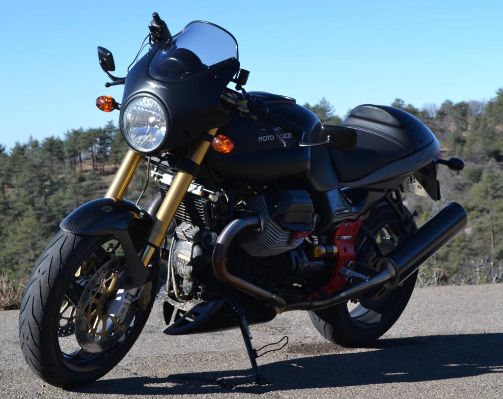

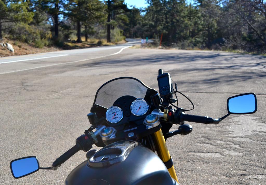

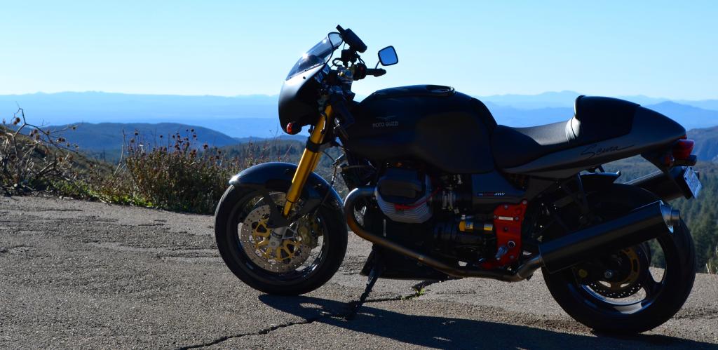

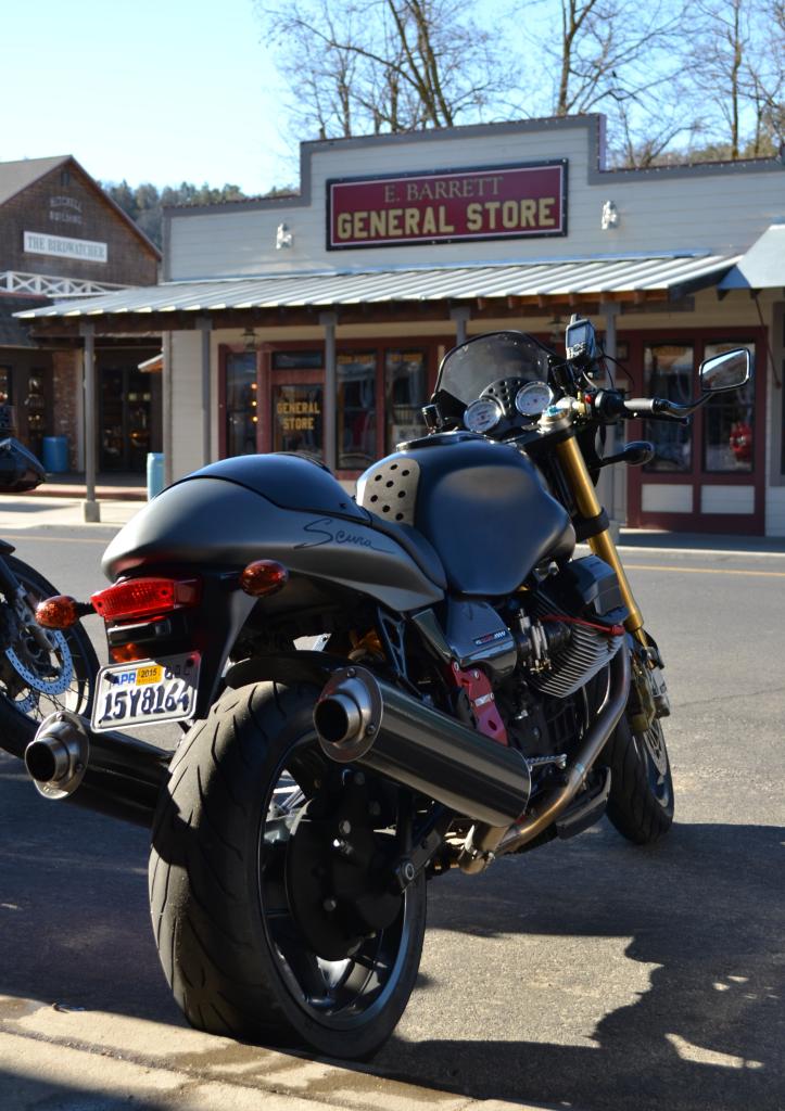

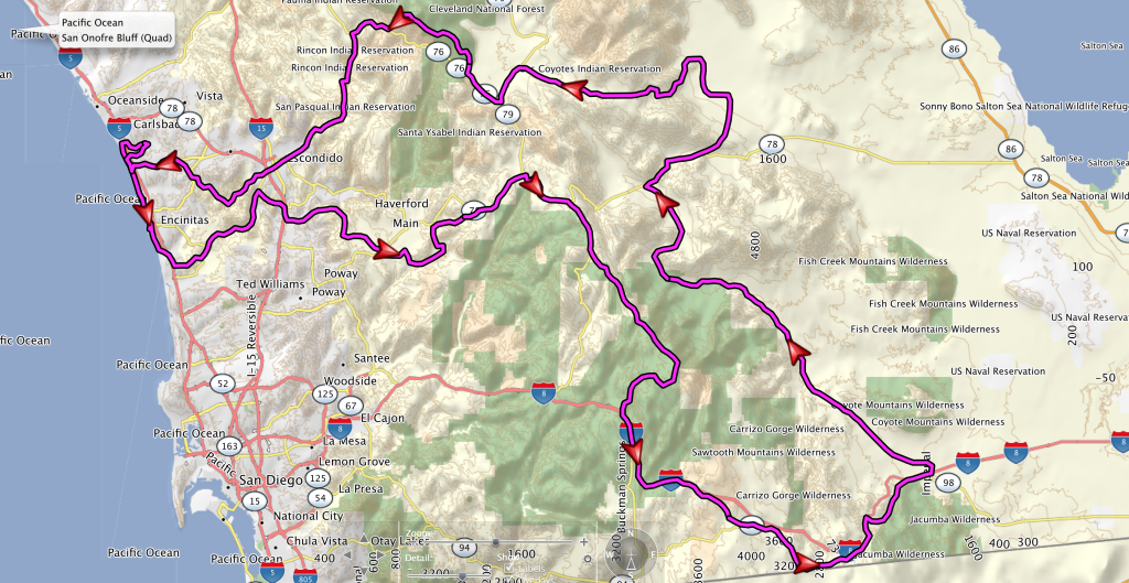

Scud Posted February 2, 2015 Author Posted February 2, 2015 I'm not going to say "I'm done" because I imagine I'll tweak something else at some point. I do have a few mechanical and electrical things to do yet, including the Roper plate, when it arrives. But cosmetically, it's Scura-enough for me. So, rather than post up some more garage pics, I took my nice camera along for a ride today. Here are the GPS stats: 320 miles 8 hours (6am to 2pm) 24,806 feet elevation. That's nearly 5 vertical miles up - and down - over a few mountains, with a few peeks over the fence into Mexico. Step One: Awaken the dark beastie. Scura con Camels Breakfast stop in Julian

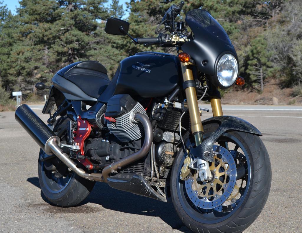

Scud Posted February 2, 2015 Author Posted February 2, 2015 Photo-op at an overlook on Sunrise Highway.
