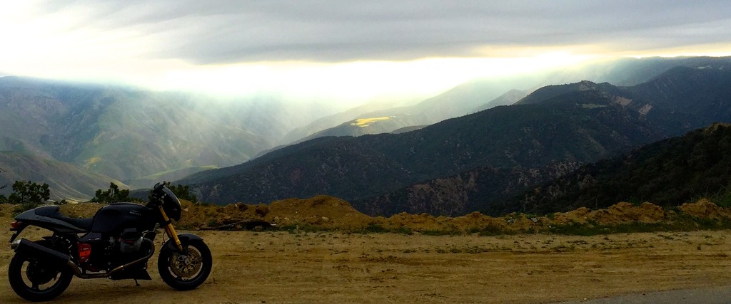

Scud Posted March 19, 2015 Author Posted March 19, 2015 Update on my timing cover leak. As it turns out, all I needed to do was re-torque the bolts. Funny that of all the bolt heads I darkened, I didn't do the timing cover. The two bolts nearest the leak came out far too easily. When re-torqued, the leak totally stopped. I figured it out two weeks ago and I just stress-tested it this week on a 1,000 mile trip - not even a little weeping. That's great news for me - and further evidence that these bikes can sit for long periods of time without dire consequences. Ironically, I transversed the Tejon pass today - also known as the Grapevine as referenced in the above post. The Grapevine is part of I-5, and I avoided the freeways by taking all the twisty two-lane mountain passes the long way over the mountains, instead of the pass, which is the shortest, lowest elevation way.
