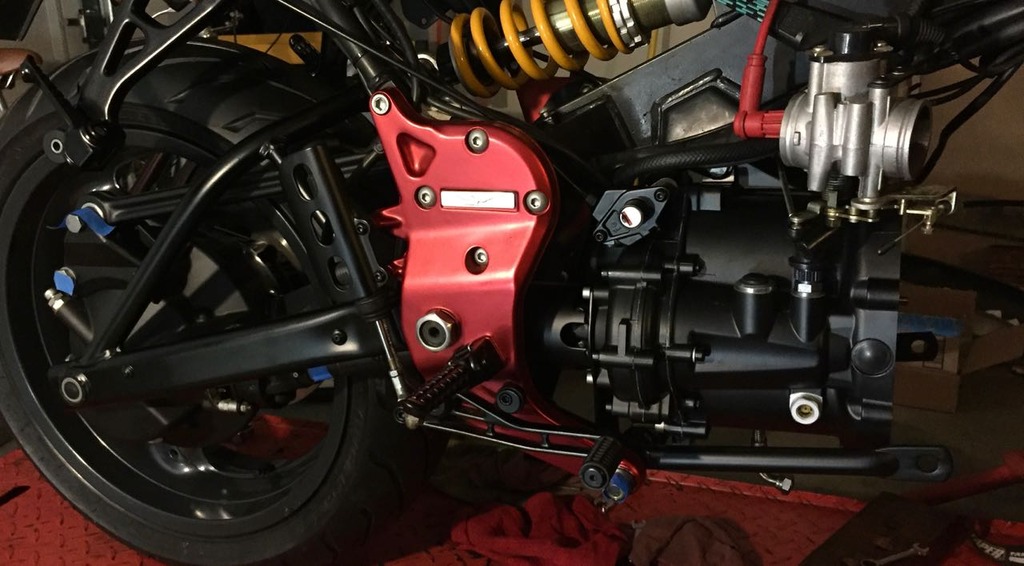

Scud Posted November 19, 2016 Author Posted November 19, 2016 Tranny is back in, along with fresh powdercoat on: lower subframe, driveshaft collar, rider pegs and brackets, seat lock housing, Lucky-Phil shift extender, and upper throttle body brace. Engine is up next... 1
JesterGrin_1 Posted November 19, 2016 Posted November 19, 2016 Tranny is back in, along with fresh powdercoat on: lower subframe, driveshaft collar, rider pegs and brackets, seat lock housing, Lucky-Phil shift extender, and upper throttle body brace. Engine is up next... I do hope that what I am about to say is not out of line but. It Looks GREAT. One thing though does concern me and that is that if you powder coated the foot pegs will it not make them slippery?
Scud Posted November 19, 2016 Author Posted November 19, 2016 Thanks. Footpegs feel about the same as with the original paint.
JesterGrin_1 Posted November 19, 2016 Posted November 19, 2016 Thanks. Footpegs feel about the same as with the original paint. Sorry I was not aware that they were painted originally as they looked like they were simply bare aluminum. But I just have to say it again. BEAUTIFUL Job.
