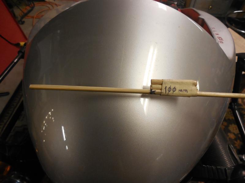

docc Posted January 11, 2015 Posted January 11, 2015 Seems the Öhlins oil level tool might be more sophisticated than the Marzocchi version . . .
Scud Posted January 11, 2015 Author Posted January 11, 2015 That's funny. I didn't get an Ohlins tool for the oil level, - just a generic one from the local Cycle Gear shop. It looks like you put in a straw (with measurements on it), clamp it at the right depth and use the syringe to draw out everything above that depth. Simple, quick, and precise. I paid someone to do my dirt bike forks last time - and they're probably ready for another change. So I figure this tool will get some use.

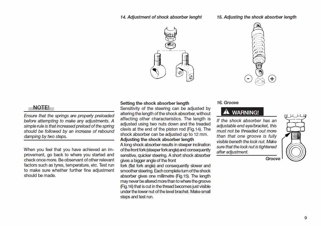

Baldini Posted January 12, 2015 Posted January 12, 2015 Scud: Re. "shock absorber length": Do you mean changing sag by adjusting spring preload? Shock length is fixed, there's no ride height adjustment other than by altering preload. If you now have sag within range you're fine. Reduce/increase sag by more/less preload. Setting sag is basic, first step. You can alter damping settings to suit yourself. A good place to start is in the middle of the adjustment range, as you are doing - I wouldn't worry about "factory settings". If you ride the same stretch of road over a few times, & vary damping settings by two or three clicks each time (changing one setting at a time) you'll figure how each adjuster affects bike behaviour. Ohlins adjusters are very effective & after a while you'll be able to notice even very small adjustments. One click makes a difference. There is a big range of adjustment & the danger is that it can be set way off correct. But once you've figured what everything does, you can tailor damping characteristics to where & how you're riding. I think a Guzzi has too much weight on the back & transferring weight onto the front helps handling in the twisties. As guzzimoto says, raising the forks in the triple clamps drops front, steepens rake & makes for quicker steering. I don't know how much each of these factors contributes to the change in handling, I suspect both are amplified by increased weight transfer under braking & into corner entry & through the first part of a corner. It feels easier to hold a line, & reduces the tendency for it to run wide. It also helps in getting your bodyweight further forward. Being able to hold the line & put weight over the front makes the bike feel more planted in the corner. This is just how it feels to me. I'm interested how it works but I really don't know the physics of it. I could be confusing different things - maybe someone else with more understanding can explain. I don't know about stability in other situations - I have not noticed any increased instability at high speeds, but then I don't tend to do high speeds, I set my bike up for twisty road handling. The Scura is a long, slack bike so it doesn't concern me unduly. But I also think Scura is big, heavy & flexible & if you push it too hard, no amount of suspension twiddling will stop it getting out of shape. Tyres also have a huge effect on handling. Different profiles have big effect on steering. To qualify everything I say - I only know what I learnt messing with my bikes over the years - Scura is the first time I ever had fancy suspension on a bike - previously I'd never heard of "sag": I just thought the forks & shock where there to hold the bike off the ground. There are far more qualified people here to explain it all, & point out where I'm wrong. This is just stuff I've figured out that works for me, we all ride different & maybe others will have different preferences. Good luck. KB
Scud Posted January 12, 2015 Author Posted January 12, 2015 @Docc - Wow, there's always another level. I think I'll stick with the oil I already bought. You are right that oil type and oil level (aka air gap), are other adjustments, along with tire size, shape, tread, pressure, total weight of rider(s) and gear, etc... not to mention road conditions and highly subjective opinions about what constitutes "better" handling for various purposes (touring, sport-riding, commuting). Throw in some confusing language and inconsistent use of terms and it's no wonder that the suspension topics go on forever.............. @Baldini - I'm following in your footsteps with the Scura. It's also my first time having such a nice suspension on a street bike (I actually felt a bit obligated to learn how to use it properly). Re factory settings - my intent is not to set them and leave them there, rather, it is first to ride it "as designed" and use that as the base-point for my adjustments. The PO clearly made a lot of adjustments. So far, putting them back to spec has resulted in improvements for me. I think there will be a hex-wrench in my jacket pocket for a while... so I can adjust the compression and rebound settings on the forks (the shock adjustments can be done without tools). Re shock length - the attached page from the manual shows what I was talking about. However, the Scura does not appear to have an "adjustable end eye/bracket." If it did (I am speculating and trying use my new vocabulary words in sentences) it would appear to increase rake (same as lowering the forks in the triple clamp) without decreasing trail (because rear is lengthened, rather than front shortened). Anyway, there's the difference between theory (reading books) and practice (turning wrenches); I can imagine adjusting the shock length while reading the book, but when I looked again (just now) there was no nut to turn. Re riding style - during a spirited romp through the twisties, I do tend to get forward on the seat and put more weight on the bars - I also generally use light brake pressure on the front through the corners (a trick I learned on my old BMW boxer that has served me well). I don't go "fast" either, but 90mph is frequently just going with the flow of traffic on the freeways. Sometimes I go slow and enjoy and enjoy the scenery. Thanks again (to everyone) for sharing your experience. Between the manuals (as corrected) and what I've learned here, I'm about ready to claim that I am a suspension-tuning amateur - that's good enough for me.
Baldini Posted January 12, 2015 Posted January 12, 2015 Scud, no the Scura doesn't have the adjustable lower eye. It's fixed length. This stuff confuses me ...hopefully someone will correct me if I'm wrong...but my understanding is: Dropping the nose or lifting the rear is going to increase rake & reduce trail, however you do it. It's not a product of lengthening the bike, it's the angles it presents to the ground that gives these specs. If you draw a line through the steerer tube to a point on the ground, & a line vertically thru the front wheel spindle to another point on the ground, the distance between the two points is trail. If you lift the rear or drop the front of the bike, you will bring the first point back toward the second, increasing rake & reducing trail.
