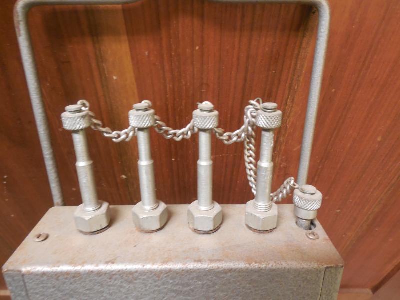

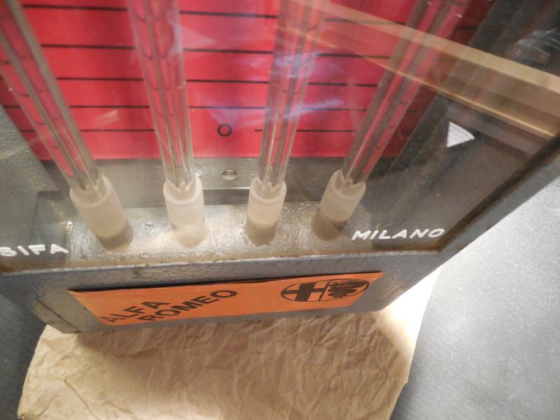

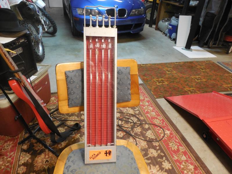

docc Posted November 15, 2014 Posted November 15, 2014 I've always used my Motion Pro mercury sticks, but sometimes think about putting this ALFA Romeo synch tool into service. The tubes are about 50 cm, so I'm rather sure it would require mercury.
gstallons Posted November 16, 2014 Posted November 16, 2014 Yes...it will be up to the owner to decide how to procure the " stuff " that goes in them .
Kiwi_Roy Posted November 16, 2014 Posted November 16, 2014 If all the tubes are connected to a common reservoir and it's not open to atmosphere you could use any fluid e.g. oil The unused tubes would need to be plugged off. You would fill it with oil to a point half way up the tubes Show me a picture of the rear and reservoir and I will elaborate. One has to wonder what happened to the mercury that was there before. Your Guzzis are spoilt, Persian rugs to sit on

docc Posted November 16, 2014 Posted November 16, 2014 If all the tubes are connected to a common reservoir and it's not open to atmosphere you could use any fluid e.g. oil The unused tubes would need to be plugged off. You would fill it with oil to a point half way up the tubes Show me a picture of the rear and reservoir and I will elaborate. One has to wonder what happened to the mercury that was there before. Your Guzzis are spoilt, Persian rugs to sit on (Not to hijack the thread, I hope) Back is sealed, fill tube on right, reservoir appears to be about 1" x 4". Something heavier than motor oil?
Kiwi_Roy Posted November 16, 2014 Posted November 16, 2014 I'm guessing that when the unit is not in use all the mercury would disappear into the 1 x 4 reservoir so its really 4 separate vacuum gauges. It may still have mercury in it but I wouldn't use it that way. Mercury is now considered a hazardous substance, spill just one drop on your garage floor and it will put you over the current "Safe Limit" As it was it would compare the manifold vacuum to atmospheric pressure so it needed mercury. If you fill it to the point say 25% full scale and the reservoir is sealed it will act as a differential type comparing one manifold to the other (not to atmosphere) so it doesn't need a heavy fluid. The unused tubes would also need to remain capped otherwise you will suck air With oil it will also be about 15 x more sensitive. Really I think you should just screw it on the wall as a talking point. I have my manometer filled with oil, it rarely goes more than about a foot out of balance before I shut down and tweak the screws.
