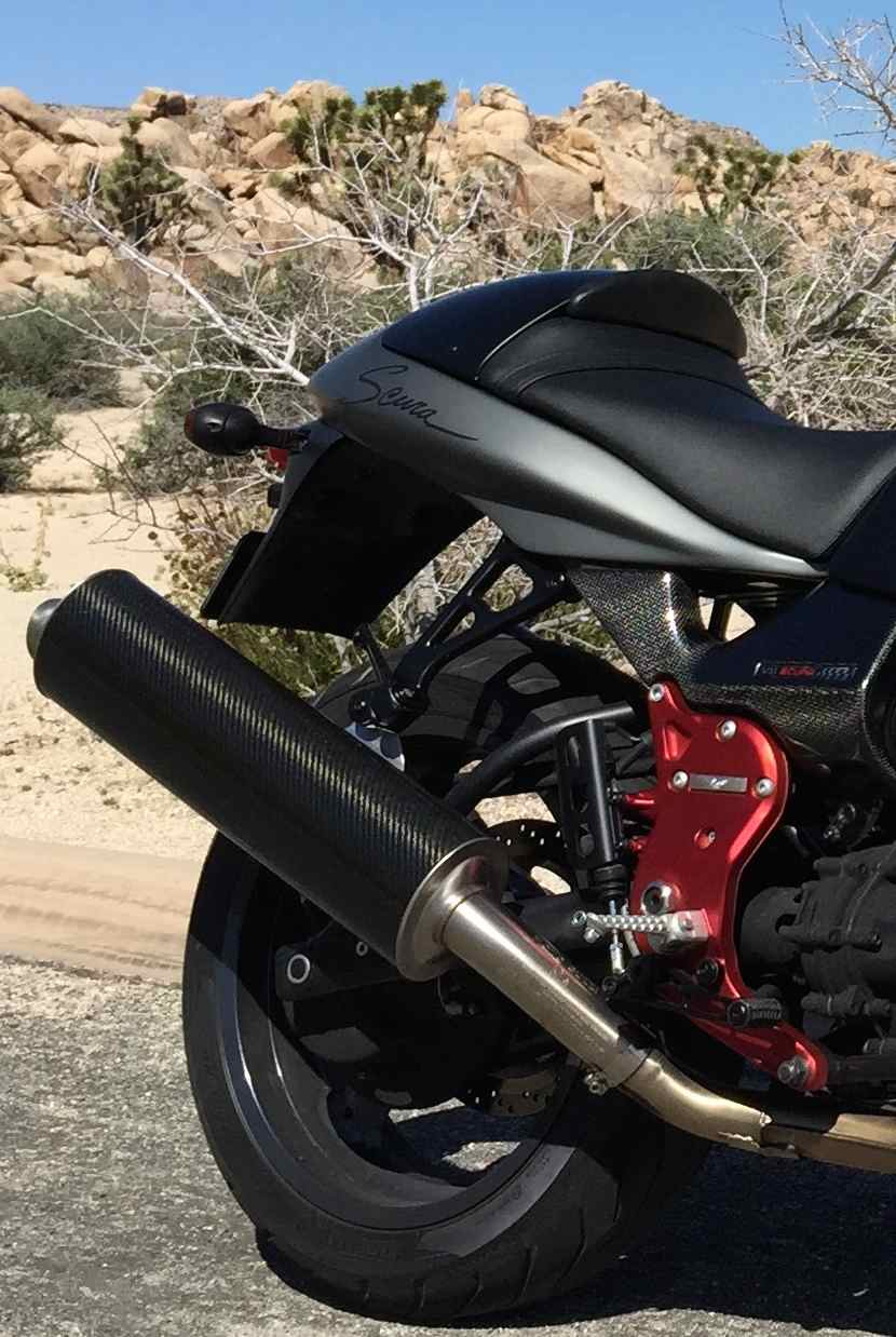

Scud Posted May 4, 2015 Author Posted May 4, 2015 Free rear fender. All you have to do is find it somewhere along the blue line on this map. Fender was in good condition when last seen, but may have a bit of road rash now. Here's a picture of the stress point. It was clearly a bracket failure; the fasteners did not come loose. So if anyone (Craig) has yet to install this, think about how to reinforce it. I'm going to let GB know what happened. I only put about 5,000 miles on with this fender - and it gave up Saturday (just noticed this morning before work). Therefore, I retract my endorsement for this fender unless (until) a better bracket is available. Sure was pretty while it lasted.
Scud Posted May 4, 2015 Author Posted May 4, 2015 wow ... and sh!# and some other words too. And money flying off my bike... Anyway - looks like I was fenderless in Joshua Tree National Park. Wanna help me look for it? The road through the park is about 60 miles of uninterrupted curvy roads with perfect pavement.
chamberlin Posted May 5, 2015 Posted May 5, 2015 OH man! So sorry to hear about the loss of the fender! Makes me want to safety wire my chin spoiler! It's very possible it survived the fling-off, only to be destroyed by a semi-truck. If it's still on the side of the road someplace though, you might have a darn good chance of recovering it, but that's a tough haul to drive and concentrate on the shoulder of the road for 120 miles (60 each side of the highway back and forth).
Scud Posted May 5, 2015 Author Posted May 5, 2015 Well, according to my GPS track, it's 211 miles from my house to where I took the picture above. The fender is somewhere out there... so any treasure hunters can concentrate on the Southern half of the loop. If I do that 400 mile loop again there's no way that I'll be going slow enough to look. I wasn't serious about looking for it anyway - just having a laugh at my own expense. The Ghezzi Brian chin spoiler is solid. The brackets are strong and it's mounted in four places on rubber compression fittings. I'm not worried about that - but it's worth checking to make sure they're snugged up. See Jaap's warning regarding the fender mount on the previous page of this thread.

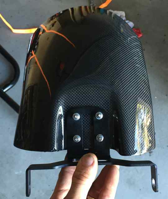

Scud Posted July 12, 2015 Author Posted July 12, 2015 New fender, bracket, and mounting hardware arrived. This bracket is NOT going to break; it's about 3mm thick. I'm glad that Ghezzi-Brian responded by improving their product. FYI - they also now accept PayPal.
chamberlin Posted July 12, 2015 Posted July 12, 2015 Wow that is a huge improvement - looks to be very well engineered. Good customer response, coupled with his leap into the 'internet age' by accepting PayPal, should help his business move forward much quicker! Thanks for the update Scud! 1

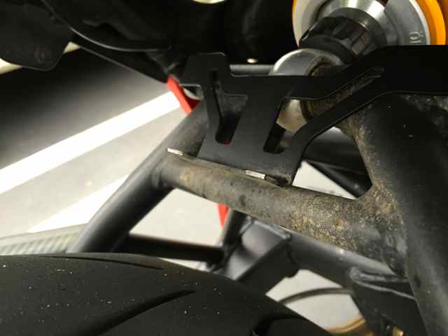

Scud Posted July 26, 2015 Author Posted July 26, 2015 Installed the fender today. Here's why it's better than the old one: Thicker bracket material - does not bounce like the old one and I expect that the bracket will not break It no longer rubs on the lower shock mount It comes with sturdier mounting hardware Critical comments/mods required: The bracket needed to be reamed out for the shock bolt to pass through it It seems that it could do with bigger washers - so I got some It's still tricky to get it aligned correctly (holes not pre-drilled) The fender itself still has an odd curve in it as Jaap noted earlier. I mounted the fender to the bracket before installing it this time (much easier than installing bracket first). These pics show how the fender needs to align to the bracket in order to look straight when installed. As for function - I've been running the stock fender on the Scura and noticed that it does get dirtier with the stock fender, so even if it's only to prevent road debris from accumulating, especially on the shock, I'm happy to have it back on. I still think it looks cool. 1

Scud Posted November 16, 2018 Author Posted November 16, 2018 Still fine - but the bike's been sitting too much recently. The fender cannot hit the tire, because the bracket would contact the swingarm first. 1
