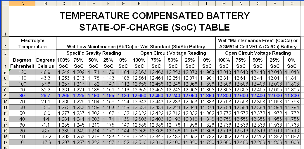

docc Posted December 21, 2017 Author Posted December 21, 2017 Looks like State of Charge voltages for the AGM are about 0.1 volts lower at that temperature (ie: full State of Charge at ~24ºF/-4.4ºC = ` 12.7v): At that temperature, observe how long it takes to statically discharge to ~12.55v, then discharge and charge with proper voltage/amperage. It's nice when these batteries will hold above the charge threshold for weeks, but I would not expect months . .

docc Posted December 23, 2017 Author Posted December 23, 2017 I'm not good at converting C to F. This is one of the reasons I like *graphs*, not >tables On a graph, the line would remain the same showing full State of Charge in vDC versus Ambient Temperature. Both temperature scales could be overlapped on the Y-axis. I looked, and looked. And looked more. But could not find such a *graph*. It has to be for AGM/ VRLA. And for "State of Charge" or even OCV (Open Current Voltage) even though those two things have nuance differences. All voltages (SoC, OCV, Charge Voltage, Float Voltage) should be temperature compensated.
