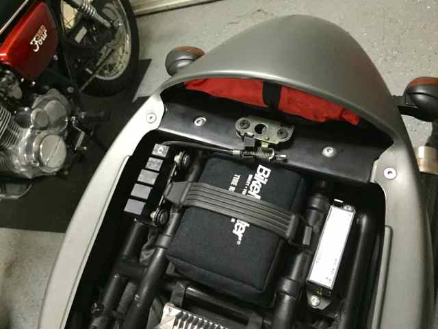

Scud Posted January 14, 2015 Author Posted January 14, 2015 I noticed Docc used a battery strap over the tool tray - and whaddya know? My bike has unused hooks there too. Bonus - the BikeMaster tire repair kit fits perfectly in there - and there's lots of extra room in that zippered case - and the seat still closes. Tail section on mine is different - and the tool roll fits there. I've still got all kinds of room for fuses, towels, shift return spring, multi-tool, etc..... FWIW - I got a great dirt-bike tool kit from themotostop.com for my dirt bike. They sell street tool kits too. Battery strap $14 and spring $10 at MG Cycle.

docc Posted January 19, 2015 Posted January 19, 2015 Yeah, well . . . the V11 relays are critical components. Ditch all the 4 pins, get the 5 pin OMRONS. Clean your ignition switch, don't let your battery terminals get loose, or your main ground fail. Look at that 30 amp regulator fuse. Did I say OMRON relays?
Zooter Posted January 19, 2015 Posted January 19, 2015 Do you need new sockets for 5 pins where 4 pins used to be?
