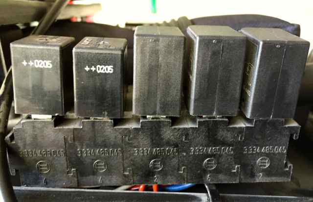

Scud Posted January 19, 2015 Author Posted January 19, 2015 OK Docc - I am going to see if I "know my relays" please correct or complete my understanding. Loving them seems a bit premature; we just got introduced a few hours ago... I see five sockets that appear to be the same. They all have the same part number 3334458045, but each one has another number at the bottom - from left to right (which is back to front on the bike), they are: 4, 4, 2, 6, 7. The two left-hand, smaller relays are the same and their sockets both have 4s, so they are interchangeable for sure. The next two are the same (but different than the first two). The fifth one is unique - the little wiring diagram on it shows 5 connections, so this must be a 5-pin. You are saying that: One type of 5-pin connector can be used in all 5 sockets: the Omron part #G8HN-1C2T-R DC12 that comes up when I follow your link. Do not replace the sockets (the jigsaw-blocks that the relays plug into). This is Zooter's question. Replace all my stock relays with the Omron units or voracious vultures will circle ominously overhead while I ride through the desert. Carry a full set of 5 more. (Are they so prone to failure that I need to have so many on hand?) I should find some more V11 owners to go riding with. BTW - I disconnected the battery before pulling them out to get a closer look (and then plugging them all the way in - they were pretty loose as shown in the pic). Is it safe to swap them with the ignition off and the battery still connected? Your picture in post 22 of this thread does appear to have all 5 relays the same. They are labeled S, I, N, ECU, and FI. Can we cheat off your homework or do we have to do our own? I think I can guess what what 3, (maybe 4) of the labels mean, but do you mind explaining all 5 just for certainty? Can we assume ours are in the same order? Dang, that's a lot of questions...

docc Posted January 20, 2015 Posted January 20, 2015 Soooo , I hope I haven't dug too many deep holes here . . . First, let me say PyroDan ( http://www.dpguzzi.com/ ) is a true gentleman and has provided excellent service to the Guzzi community for many years. A real unsung hero! I've gotten relays from Dan, both Bosch and GEI. The last relays I recall him offering (at a great price and convenience) were the Chinese GEI. Some years back a member here (Ryland3210) disassembled both the GEI and the OMRON and did an extensive report on their internal construction. I thought his work very competent and have used OMRON since (7 years/43,000 miles/69.000 km). I do carry extras, but have never seen an OMRON failure. The labels on my tail cowl: S(tart), L(ights), N(eutral), ECU, FI (fuel injection. Adding these labels and the complete fuse description next to the components will get you ( or your buddies) off the side of road much quicker than googling the owner's manual. And, yeah, I believe all the relays are in the same order for the entire V11 series. I'll post this and look back at Scud's post above to see how much more homework I've got. EDIT/ 07 February 2017: *Best* relay: http://www.v11lemans.com/forums/index.php?showtopic=19755&p=216605
docc Posted January 20, 2015 Posted January 20, 2015 Alright, almost done, then: Only the front/first/Starter relay is 5-pin. All the rest will work on 4-pins. But IMHO there is no reason to chance that a 4-pin might get rotated into the first position and complicate a road side circumstance. The 5-pin will seat in every position, simply not making contact with the fifth (center) pin. I cannot count the spare relays I've carried that are running around in other folks' V11s . . . A far as choosing to use OMRON and carrying spares - why skimp? They're not very expensive, really, and positions #1 and #2 likely the single most failure prone issue in the V11. For the 5 question quiz then: 1. Yes, but G8HE (High Current) 2. No, no need to replace the sockets, but Kiwi_Roy reminds us that the connections must be clean and tight. 3. Some places I ride, the vultures are the least of my worries . . . honestly, there are members here who running their original Siemans with no trouble. Yet, many of us routinely use the highest quality fuels, lubricants, and components available regardless of cost. I extend this philosophy to the relays. 4. With the bases clean and tight, and quality relays in place, you're *probably* good to go. Spares are cheap and easy to store. 5. Yes, by all means! For the record, I started the South'n Spine Raid back in 2004 because I'd only ever seen one other V11 and my dealer (125 miles away) had closed up shop like Pressed Rat and Warthog. The Spine Raid has been a crucible of V11 experience. Re: "BTW" - Yes, you can take the relays out with the ignition off without disconnecting the battery. Pull them straight up and out! Don't wiggle or waller as this can spread the connections in the bases (the bases themselves are mounted loosely, but the connections to the relays' spades should be tight, or follow the link above to Kiwi_Roy's Relay Base method). I hope teacher doesn't keep me after school . . . 1
Scud Posted January 20, 2015 Author Posted January 20, 2015 Thanks - I ordered 7 Omrons. 5 as replacements and 2 spares. I'll keep the current 5-pin relay as a 3rd under-seat backup, and ditch the quad-pins. It's not the small expense (heck, I spent more than that changing silver bolts to black ones on my bike for no functional reason whatsoever) - just really trying to understand anything that I change. I like the simplicity of all five relays being the same part number. Knowing that two of these are likely to fail - and now having a plan to have extras on the bike puts me in a better position to "fix it on the road." What was that saying I saw somewhere? "Moto Guzzi - making motorcyclists into electricians for over 50 years."- or something like that. I guess it's better than "Lucas Electric, the prince of darkness." It would be cool to "spine-raid" with you all - but that's a long way from here... We need a "surf'n spine raid." 1
