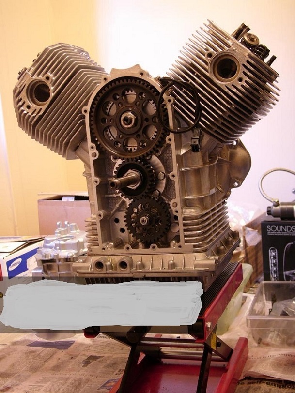

Lucky Phil Posted November 7, 2018 Posted November 7, 2018 On 11/5/2018 at 10:39 PM, Dadparent said: Does anyone have a adress for gearset in Europe? Of UK? Thanks Verzonden vanaf mijn iPad met Tapatalk Pro I have a steel set for the V11 and also for the Daytona engine from Joe Caruso in England but not an email address anymore. He is on linked in though.I dont think he's made them for years but if enough people get together he may run a batch. EDIT Try this... no garantees though. Sent him an email to say Hi and it didnt bounce so far. joe.caruso@ntlworld.com Edit 2....Joe got back to me and he's still making gears, so if anyone is interested drop him a line. Imagine these bad boys in your timing chest. Better than that agricultural chain:) Ciao 3
