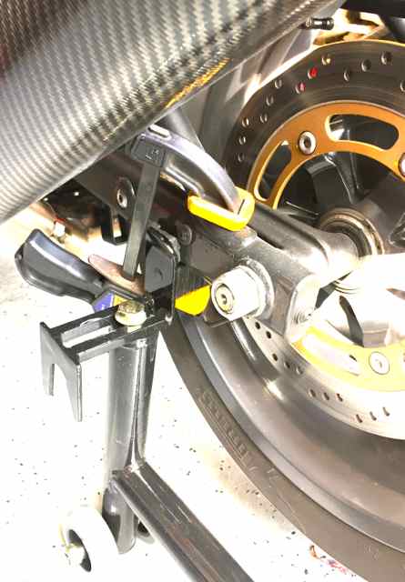

Scud Posted February 19, 2015 Share Posted February 19, 2015 When attaching it. Its like a intimate dance with a overweight but yet sexy Italian. You and your bike in a balancing act. The first couple of times you are nervous then after a few dances you are a pro. And sturdy as hell. That poetic description also works for my use of the Cycle Gear stand. With the sidestand down, I get on the right side, pull her up and close up to me with my right arm and use my left arm to prepare to sweep her off her feet with the swingarm stand. I had help the first few times, but I can do it alone now. The lifting surfaces of the CG stand are two square rubber blocks that rotate. I added some leftover surfboard traction pad foam to the brackets to prevent damage while lifting. When it's up, I secure it with two clamps, as shown in the picture. Again - probably not the "best" option, but it works and it doesn't slide off. I have left the bike on the swingarm stand like this for well over a week (while the sidestand was getting powder-coated). Link to comment Share on other sites More sharing options...
