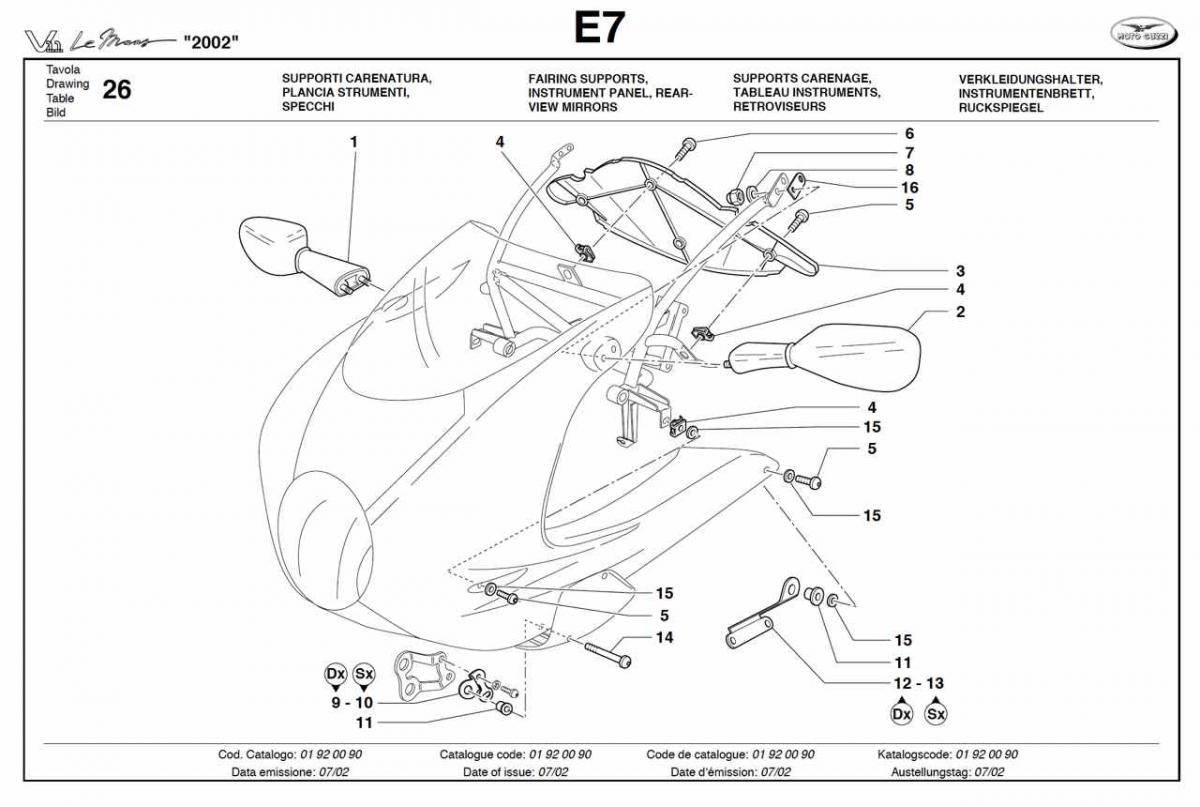

Craig Posted February 23, 2015 Author Posted February 23, 2015 I wonder if the stock LeMans fairing support can somehow be wrangled into working with this fairing. The part number is 01578660… Does anyone have a picture of it? What material is it made of?
Scud Posted February 23, 2015 Posted February 23, 2015 I think you might be looking for part number 12 or 13 - not sure what the difference is. I am looking forward to this project. I found this article (which I cannot read) but it has more pictures of the same bike with the fairing installed.

Craig Posted February 23, 2015 Author Posted February 23, 2015 Screen Shot 2015-02-22 at 11.05.44 PM.jpg I think you might be looking for part number 12 or 13 - not sure what the difference is. I am looking forward to this project. I found this article (which I cannot read) but it has more pictures of the same bike with the fairing installed. I think 12 and 13 are right and left. Those are similar to what I am thinking. Simple sheet metal brackets mounting in the rear. I need to see the fairing mocked up to figure whether they would work or not. I also need to see if the fairing is stiff enough or needs more support. Hopefully I can find a way that I can mount the fairing and be able to do a valve adjust without removing it. I got an email from MotoForza this morning saying my ordered had shipped. So far, I feel it has been good communication. There English is far better than my Czech!

sp838 Posted February 23, 2015 Posted February 23, 2015 This is the part I was referencing, number 12 in this drawing: It attaches to the steering neck tube and provides the internal mounts for the front end of the fairing. You will need it, or something like it, to mount your headlight. The little tabs you are talking about are not enough to secure the fairing properly. This bracket might be too big, because the stock LeMans fairing is bigger, but it would be a good starting point for you because it has the proper mounts for the headlight and the correct connection to the bike frame. The mounts for the fairing itself would likely need to be cut down and or bent somewhat to suit the smaller shape of the Laverda fairing, but again, you will need this, or something like it.

Craig Posted February 24, 2015 Author Posted February 24, 2015 If I were selling fairings I would either sell full up kits or do it the way Aerotech does it. Supporting people with wildly varying skill sets would rapidly eat any available time. Providing drawings helps a few but confuses the vast majority and if they do it wrong there are always those who will blame you for their inabilities. I don't want to know how MotoForza did theirs. I can do as well and probably better. I will probably build a full support structure from the valve covers forward to the head lamp and up to the windscreen base. Much depends on how stiff the fairing is. It won't be the lightest possible but it will be sturdy. Sent from my iPhone using Tapatalk
