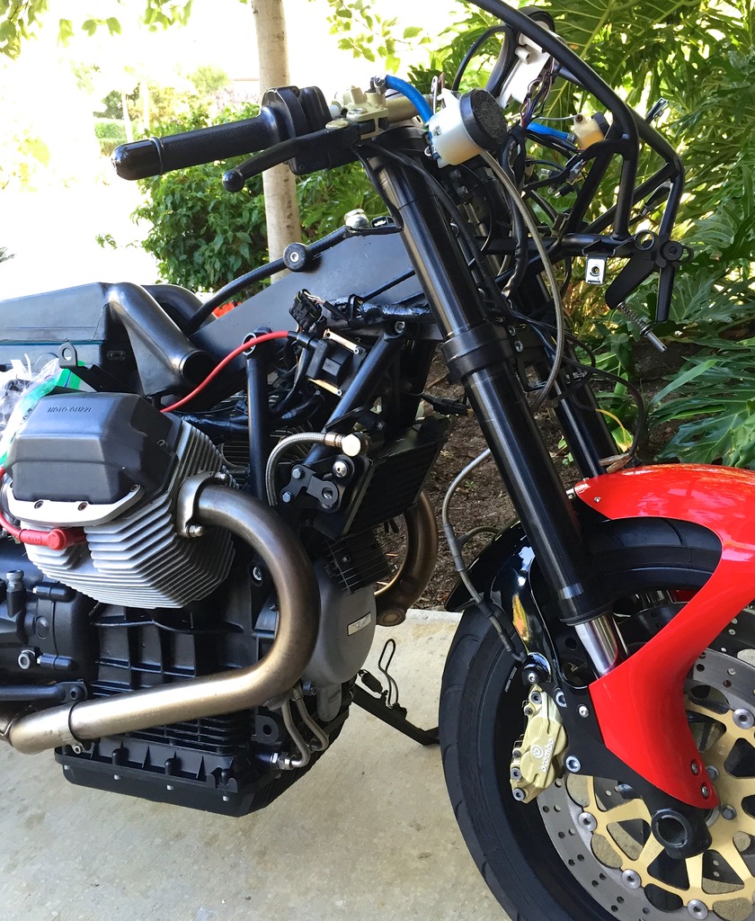

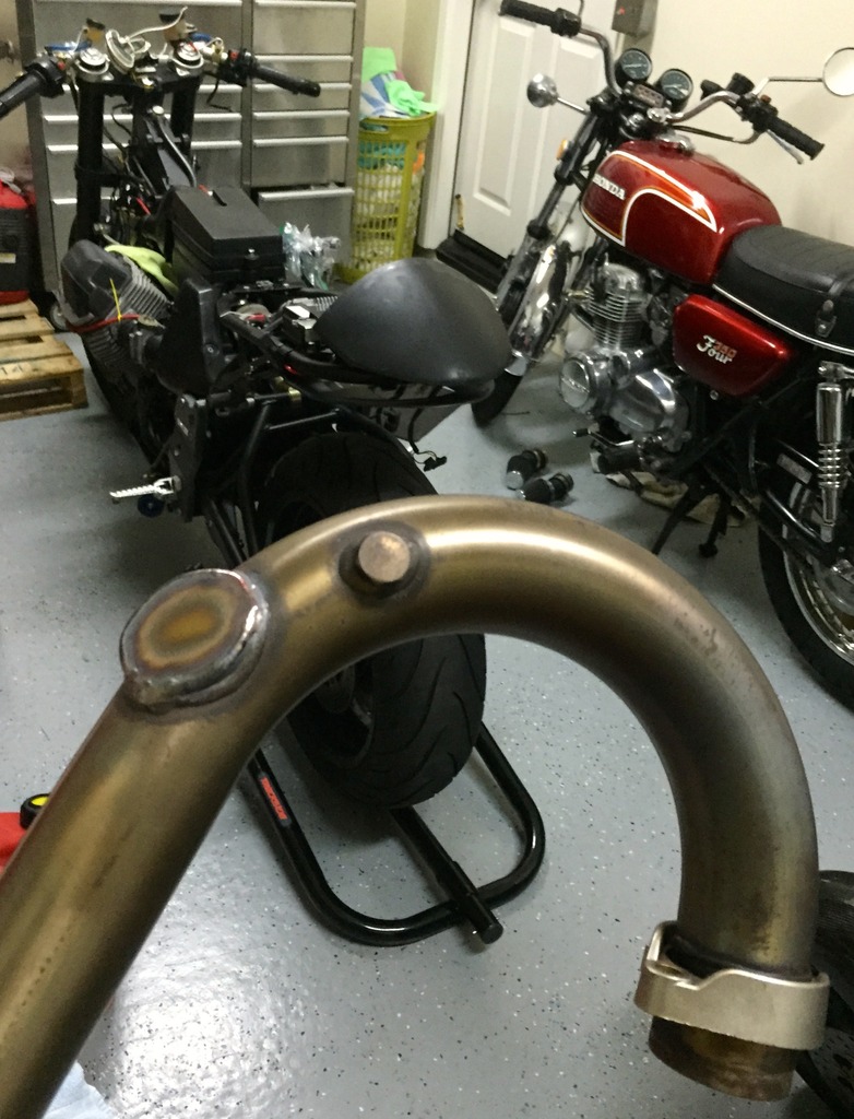

Scud Posted April 16, 2015 Author Posted April 16, 2015 More going-through stuff over the last week or so: Removed pods, cleaned throttle bodies, and fitted factory airbox (sans snorkels). Reinstalled (straightened) stock bars, raided the Scura take-off-box for the bar-end weights. Lubed throttle and high-idle cables. Rerouted hydraulic lines, cables and wires. The PO did some "cheats" to use the stock-length cables and lines with raised bars. Removed and cleaned front wheel, cleaned brake calipers, checked bearings, etc. All is well. Verified that new gauges should arrive next week, as will my box of goodies from Harper's. My batch of black powdercoated bits should be ready later this week. Picked up the cross-overless pipes from the welder. 1

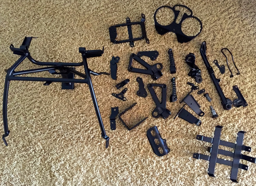

Scud Posted April 18, 2015 Author Posted April 18, 2015 Starting to get to the fun parts now. Picked up my first round of powdercoated parts. Flat black for making some things disappear and for protection and easier cleaning on other parts that were already black but with poor quality paint, or showing some wear/weathering (there was a little rust on the battery tray). Put the sidestand and dash on last night... now the dash looks better than the triple clamp... FYI - I used QuickSteel to fill in a few imperfections before powdercoating (it can handle the heat). There are two kinds - a two-part putty in a tube and a premixed paste in a canister. I tried the paste, but will use the putty next time, because it goes on smoother and is easier to sand, the paste is more gritty. Buying a bike with an uncertain past and a broken odometer carries some risks. Some things I've found made me wonder if the bike had more miles on it that claimed - then other things (like an old date code on the front tire) support the low mileage. They just weren't easy miles - and the bike was not always garaged. Hoping to have it back together functionally, balance of fluids replaced, and re-tuned by next weekend. Then ride it a bit while I ponder other promising possibilities, perhaps paint?
