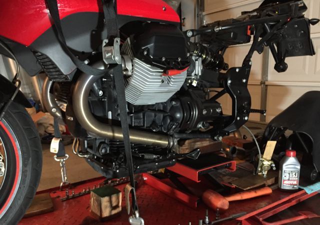

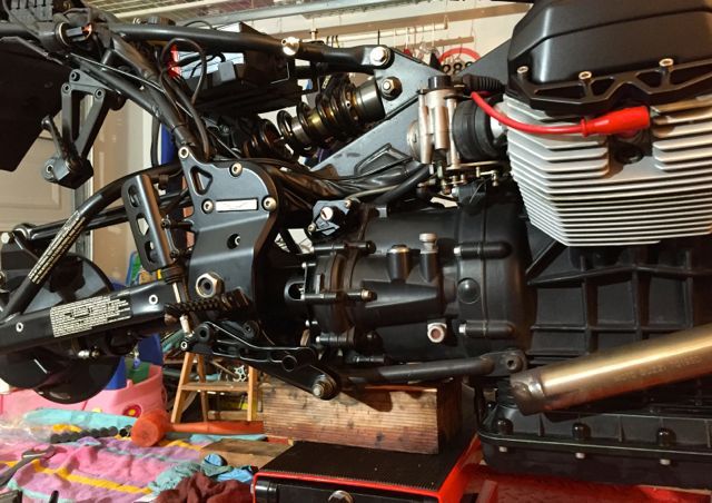

Scud Posted January 24, 2016 Author Posted January 24, 2016 Got a little play-time today. Here are some recently powder-coated (flat black ) bits: Alternator cover Valve cover Plug guard Pork Chop Shift lever (if you can't see it, that's the objective...) Footpeg (and bracket) (previously powder-coated: sidestand and bracket, passenger peg and bracket) I may not get it going this weekend - and I have more business travel over the next two weeks. I am soooooo curious to see if my oil pressure will be higher with the new gaskets (due to missing bit of old gasket posted elsewhere). Note ubiquitous and obligatory mallet in photo for tapping connecting rod through lower sub-frame (bottom porkchop nuts). Thanks to Goose/Zoup - you made me remember that I need to install a speed-bleeder on the clutch slave while the swingarm is out of the way. 1
Scud Posted February 5, 2016 Author Posted February 5, 2016 Got home from Minnesota today, where I almost got to meet FotoGuzzi - but it was the worst snow storm of the year and schedules didn't line up... (next time). Changed planes in Denver, and for some reason a lot of people there were wearing Broncos jerseys. You'd think there was some sort of important sporting event coming up... I have hardly been home at all for the last month, but I'm hoping to get her all back together this weekend - cuz it is killing me to not know if my oil pressure issue will be solved or not. Bit of progress today: Newly powdercoated porkchops are all snugged up (and eagles back on) and the swingarm and pivots from my parts bike, which (along with the swingarm bearings) were in better shape than the ones on the LeMans. Painted the ends of the pivot pins (satin black, of course) so they won't get rusty. Also powdercoated the two driveshaft collars Lubed the driveshaft splines with some Staburags grease (the kind that is specified for the BMW brick) Lubed the seat lock (cuz I already had it apart to get the housing powdercoated) - it works much more smoothly now and there was very little grease in there originally. Other new powdercoating: brake lever, bump stop and hardware, rocker cover and plug guard, footpeg and bracket. Previously done, but still in this picture: master cylinder guard, passenger peg and brackets Found an extra washer... where does it go? Figured it out, but that means I'm getting sloppy and tired (been up for 20 hours.) 1
