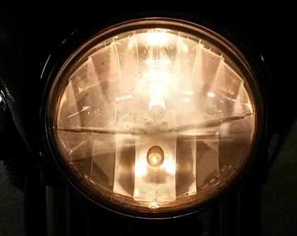

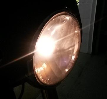

st. augustine Posted April 6, 2015 Posted April 6, 2015 Guys/Gals; need some advice on cleaning my headlight. It looks totally cloudy inside (see pics). any thoughts?
dl.allen Posted April 6, 2015 Posted April 6, 2015 mine is the same waiting for the answer probably replace as they are likely a sealed beam
Scud Posted April 7, 2015 Posted April 7, 2015 remove phillips head screw from bottom of black headlight bucket slide light assembly out of housing remove parking light (twist) remove headlight bulb (spring clamp under rubber boot) remove entire assembly from bike, place glass-down on something soft release pressure on four plastic tabs under chrome trim ring - I needed a flat blade screwdriver to do this remove trim ring and glass lens clean and reassemble 10 minute job. Have fun - and be careful of the plastic tabs. Mine had a black spot on the plasti-chrome that I was trying to remove, but it seems the finish is damaged. Bummer. Has anyone ever used this chrome spray paint? 1
st. augustine Posted April 7, 2015 Author Posted April 7, 2015 ok, thanks. I had removed the chrome ring and polished it up nice and clean with Flitz metal polish then put some Meguiar's paste on it. Man it looks nice. I'll pull it off again, remove the bulb out of the light housing and try to use a bottle brush on the inside. BTW, I don't think it is sealed, DL.
Scud Posted April 7, 2015 Posted April 7, 2015 You won't need any kind of special brush. Everything comes apart. Even the glass lens can be detached from the chrome-plastic inner piece (4 plastic tabs that snap in place - to remove you need to pry them back gently).
st. augustine Posted April 21, 2015 Author Posted April 21, 2015 I just cleaned the inside with soap and water and it looks as good as new. problem solved. thanks.
