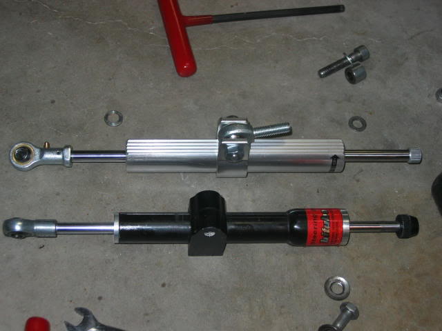

docc Posted April 9, 2015 Share Posted April 9, 2015 When my Bitubo played up at about 67,000 miles, I sourced a Japanese Shindy (pronounced SHIN-juh) from Moto International. Their item number was PUD17-001 at a price of 132.95 US$ in August 2009. I tried riding the Sport with the Bitubo drained, then removed, but didn't like the feel. 1 Link to comment Share on other sites More sharing options...

sp838 Posted April 11, 2015 Share Posted April 11, 2015 That Shindy looks pretty trick though, racing or no racing... Link to comment Share on other sites More sharing options...

Onibaka Posted November 3, 2015 Share Posted November 3, 2015 My dampher (Bitubo) is out of use and I am looking to replace it. What will fit better for my V11'02: A used one by Öhlins from eBay or a new one by Shindy (although I have not found anywhere to buy it with delivery to Belarus)? Can you recommend anything? Link to comment Share on other sites More sharing options...

Gio Posted November 4, 2015 Share Posted November 4, 2015 I fitted a 75mm Hyperpro (# DS-075RA) to the Sport in 2007 and have had no issues. Not sure if this would be same size on the Tenni. At the time Hyperpro listed the SDK-MG-101RA (for V11 Sport '99 onwards) but this did not fit so was replaced with the one I have. Link to comment Share on other sites More sharing options...
Scud Posted November 4, 2015 Share Posted November 4, 2015 I have the Ohlins on my Sucra and installed a Shindy on my LeMans. I have them both backed off almost all the way - just a a few clicks in. I'm not sure I could tell the difference between dampers. A used Ohlins might require a rebuild - so factor that cost (and time) into your decision. If your bike is wobbling, you might look elsewhere for the cause, instead of at the damper to cover-up the main problem. Causes could include issues with tires, spring settings, steering bearings, or other. Maybe somebody who knows suspension stuff really well can post more detail. Link to comment Share on other sites More sharing options...
GuzziMoto Posted November 4, 2015 Share Posted November 4, 2015 A failed steering damper can and has caused a V11 to wobble. Other things can also cause a V11 to wobble. I don't personally know if the steering damper was the cause of the issue or a result of the issue. I can't tell that from here. If the damper is bad, whether it was the cause or a result, you can either replace it with a damper of your choosing that fits the length and stroke requirements of the V11, or you can run without a steering damper. When the steering damper failed on my wife's V11 we removed it planning on replacing it later. The bike handled so much better for her tastes (and mine) without the steering damper that we never replaced it. When her V11 steering damper failed it was subtle but it would cause the bike to wobble. What hers did was it developed stiction, causing a resistance to begin moving. Once moving the initial resistance went away and it moved pretty smoothly. But that initial resistance caused you to have to apply more effort to turn the bars than it would require to keep them turning. This caused you to constantly be over turning the bars back and forth. You did not even know you were doing it. In my line of work it is like when we have a loop that is not tuned right. A loop (in my speak) looks at an input and modifies an output to hit a set point. If the loop constantly overshoots the set point we say the loop is hunting. That was what her V11 was doing. And that hunting was felt as wobbling. I am not sure if that could or would cause you to crash, not am I saying that is what happened in this case. I am just pointing out that a bad steering damper can cause handling problems. Link to comment Share on other sites More sharing options...
