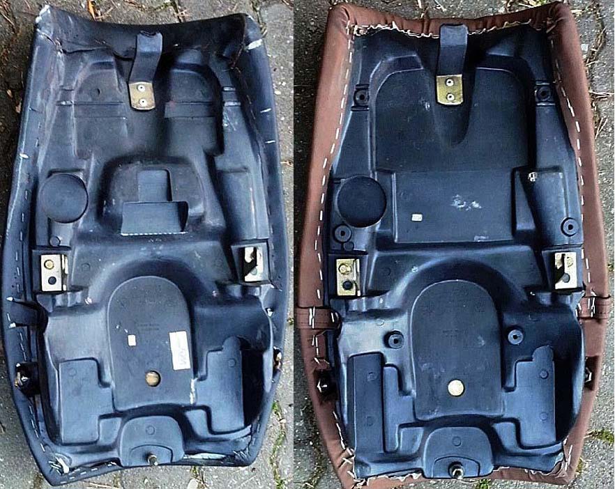

footgoose Posted July 25, 2015 Posted July 25, 2015 I recently bought a 2000 seat for the pan, to do a nice recover for my 2002. they are the same (as shown above photo) tho recesses are a bit different. It will not fit without cutting the pan and removing plastic in the few spots that are too high. Things under the seat were re-arranged from '00 to '02
