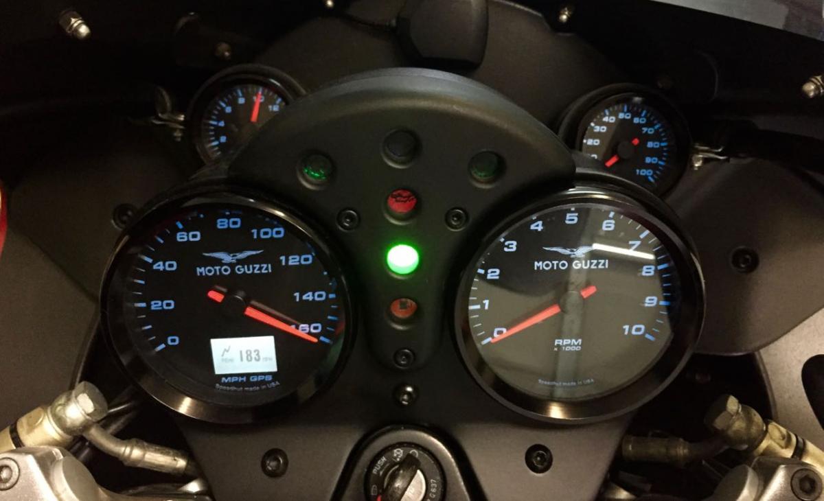

Scud Posted June 3, 2017 Share Posted June 3, 2017 I seriously doubt that your GPS is learning anything. GPS total distance measurements can differ based on how frequently they read your position. For example, when I set my handheld GPS to 30 second or 1 minute intervals, then look at the track-log, it cuts off a lot of curves and corners and calculates that I have ridden in a straight line, which is less distance than I actually travelled. Was one measurement on a twisty ride and another on a straight ride? If so I would expect the difference between the two units to be greater in the twisties. I further *assume* that the Speedhut needs to take very frequent (nearly constant) measurements in order to calculate changes in speed. Therefore, my hypothesis is that your Speedhut reads a greater (and I think more accurate) distance than your Garmin navigation GPS. How are we doing, Dr. Venkman? 2 Link to comment Share on other sites More sharing options...

Scud Posted June 7, 2017 Share Posted June 7, 2017 I'm not so sure that I like having the peak speed recorded. Obviously, this is the result of some sort of GPS calculation error... Link to comment Share on other sites More sharing options...

MartyNZ Posted June 7, 2017 Share Posted June 7, 2017 On 6/6/2017 at 7:49 PM, Scud said: I'm not so sure that I like having the peak speed recorded. Obviously, this is the result of some sort of GPS calculation error... Hmm, 183 MPH, the bikes in neutral, rpm zero, and you took a photo. My guess is that you were coasting down a vertical cliff, riding one handed, while you took that picture. Awesome! 1 Link to comment Share on other sites More sharing options...
Scud Posted June 7, 2017 Share Posted June 7, 2017 Free-fall is probably the only way my LeMans would ever see 183 MPH. I figure that top speed is so unbelievable that it could not be used as evidence against me - so I'm not gonna reset it. Plus it's fun to answer the "how fast will it go?" or "How fast have you gone on it?" questions. "Hmm... I dunno, but my speedo has a max speed setting... let's see what it says. Oh wow, 183. I thought I was only going 160. I guess the speedo pegs-out at 160." Step back and watch the eyes pop and jaws drop. Respect for the Guzzi. On a serious note - the Speedhut GPS speedo has a lot of information available including clock, 1/4 mile times, max speed, etc. When you cycle through the display options the needle moves to the exact peak speed (unless it pegs-out). My pic is of the same display function as Docc's. Obviously, my bike is faster than Docc's, mostly cuz it's red. Link to comment Share on other sites More sharing options...
Scud Posted June 7, 2017 Share Posted June 7, 2017 Today, I managed 183 miles. I'm not so sure that I like having the peak speed recorded. Hmm, 183 MPH 183. Coincidence? What does it mean? Link to comment Share on other sites More sharing options...
