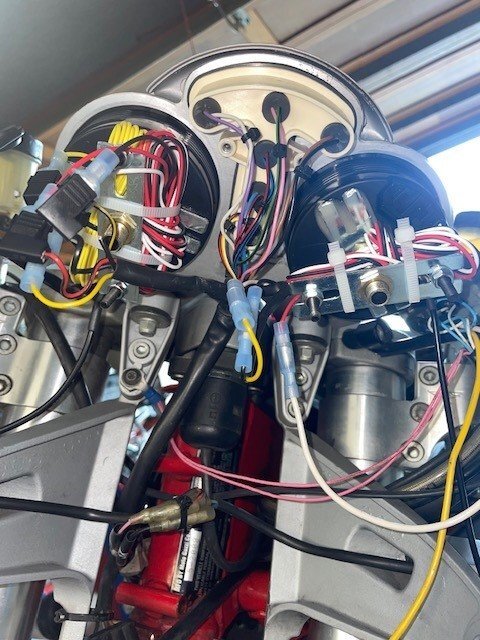

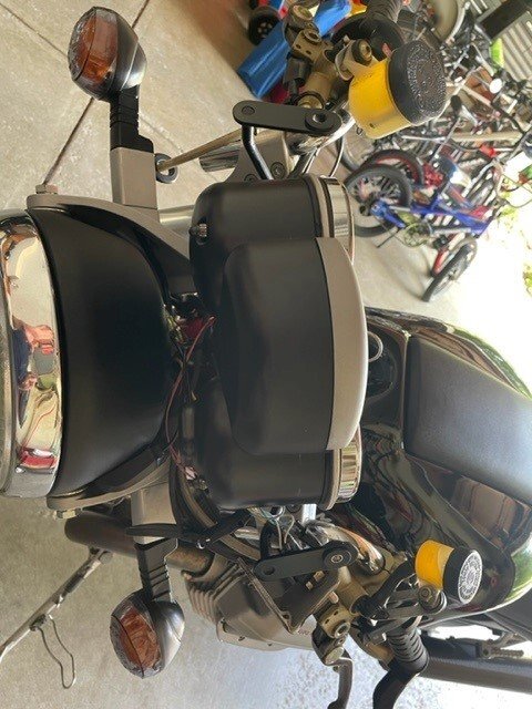

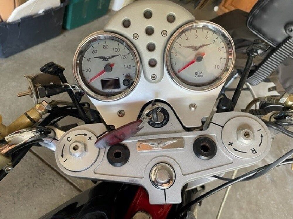

cowtownchemist Posted August 3, 2023 Posted August 3, 2023 Success! I now have two fully functional and great looking gauges! After utilizing the work bench and the housing I was able to get the bolts aligned and the lock nuts tightened with some locktite. After which I was able to get the back housing on and fasten it with the original four nuts. It definitely took a lot of trial and error to get the appropriate depth of the bolts and alignment. One tip is once I was close to where bolts needed to be, I marked the back of the gauge so that I could line them back up if I accidentally moved it while adjusting, which happened quite a bit. I set the tach to 2 PPR and confirmed it was very accurate with Guzzidiag. I programmed the odometer to the same mileage as on the stock gauge. I went for a short test ride and all functioned extremely well. I still need to take out the old speedometer cable and plug it up. I received the bolt from Zoro this afternoon. Thanks everyone for the help on this task! Here are a couple final pictures. I will update with some night pics later on. 6 1
