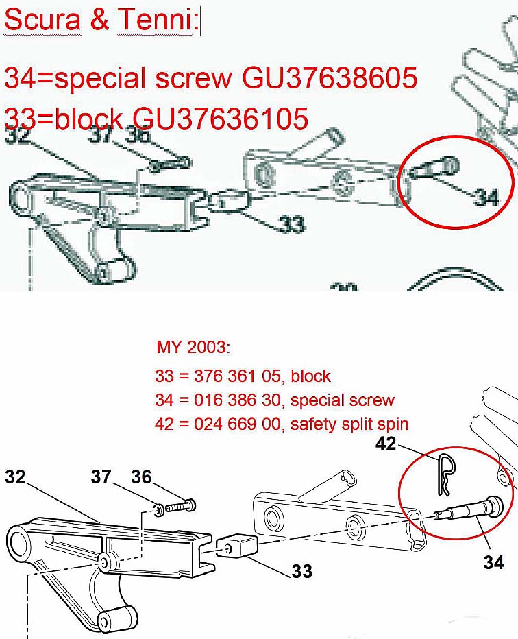

Camn Posted June 23, 2015 Posted June 23, 2015 Quote the one that goes through a small metal block that fits in a channel in the caliper bracketIf it is this one this is not the first time it happens. I remember having read about it. I have once tightened the screw (34) and do not take it out anymore. The metal block (33) is a loose part which can be taken out as a single part (the screw can stay - the tire "fits in" when taken out/back). I wonder if the new type screw with the saftey spin fits to older models ?

docc Posted June 23, 2015 Posted June 23, 2015 Indeed, the later generation (2003 on) added the longer pivot bolt with securing pin inboard (I wonder why??? ) Yet, it would appear that the later carrier bracket must also be upgraded to allow for the bolt tip to pass through (?) Like Camn, I cleaned the threads and torqued the unsecured bolt on my early Sport and NEVER take it loose, only sliding the fiddly block out for wheel removal. This phrase appears in the the Wheels Off Maintenance Checklist: >Clean the rear brake carrier pin and block; lube lightly and be certain the pin threads are clean, lubed and well torqued. (later V11s have a retaining clip on the inboard side) But I'll add a stronger warning and a link back to this thread. Thanks for posting this and so glad you are ok from the incident, H-E-Ross! 1

Scud Posted June 24, 2015 Posted June 24, 2015 Looks to me like the carrier bracket on 02/03 is the same casting - but the 03 has a hole in it for the special bolt. I think you could drill a hole in the 02 bracket and use the special bolt (part #34 in MY2003 image in Camn's post). It would be relatively easy to mark the location for the hole when everything is still on the bike - just use a center-punch after removing the bolt.
