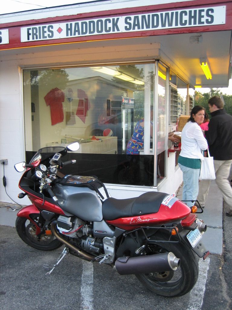

Bob Hartman Posted June 24, 2015 Author Posted June 24, 2015 Thanks for that. As you say, there are unused mirror mounts and I've been using one to attach my Garmin Quest 2. I can get away with that because it is quite a bit smaller unit than the zumo 660. Now things have changed! The challenge now is the best way to get the larger GPS closer to the center and at a distance closer to the speedo and tach: Less searching and refocusing. The wiring of it doesn't bother me; it comes with a fused line and I know where to pick up switched hots.http://i1013.photobucket.com/albums/af259/bevelbob/IMG_0719_zpsbjyj8uy5.jpg~original
