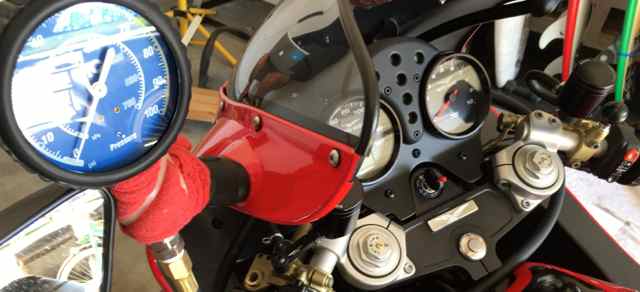

Scud Posted July 26, 2015 Author Posted July 26, 2015 Update - I managed to get a mechanical oil pressure gauge connected today (test kit). I got the same readings as posted before, which just confirms the accuracy of the gauge I installed. So there's one more thing off the list... and I got a new tool, so that's always a good day. Good looking mount, dontcha think? Meanwhile, I've been riding it almost every day - mostly my short commute - and it's doing fine.
docc Posted July 26, 2015 Posted July 26, 2015 Looks like something Carroll Shelby would have had the boys do on a Cobra at Sebring . . .
