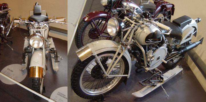

francesco Posted June 6, 2004 Posted June 6, 2004 > you should have a winter Guzzi get a Guzzi Cicogna
