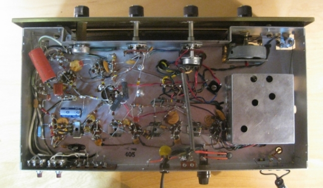

al_roethlisberger Posted January 6, 2019 Posted January 6, 2019 FM-50 underside after restoration. The big coupling cap has actually been changed to a Mundorf oil capacitor since this photo was taken. The FM-50 is unique in that it has a recording level circuit, which is actually a simple preamplifier via a 12ax7 tube, so the tuner has a volume control built in. So I can connect the output of the FM-50 directly to the 30-A amplifier. I think I've either got a vintage NOS Telefunken or Bugle Boy in there now. https://www.radiomuseum.org/r/fisher_fm_50.html

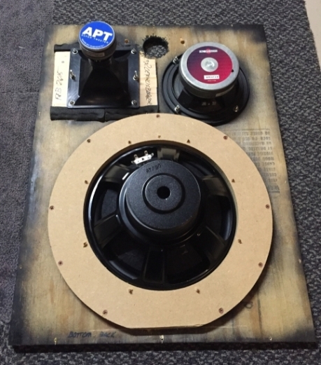

al_roethlisberger Posted January 6, 2019 Posted January 6, 2019 I'll try to remember to post some finished photos once complete, which should be in a week or two, but here is a photo of the rear of the cabinet open with the crossovers and rear firing bi-polar dome mid-range speaker which makes the mono speaker sound a lot more spacious. Since the tuner and amplifier have no tone controls, I have pots on the horn tweeter and midrange themselves, as well as the ability to switch the crossover in/out for the mid-range making it full-range. 1
al_roethlisberger Posted January 6, 2019 Posted January 6, 2019 Speaker compliment, all high efficiency to match the 12-15W 30-A amplifier. One might be amazed how loud 12-15W is when the speakers are high efficiency. Kids today chasing 100s or 1000s of amps of power just don't understand. Exponential horn loaded tweeter 5" midrange 12" woofer 2
