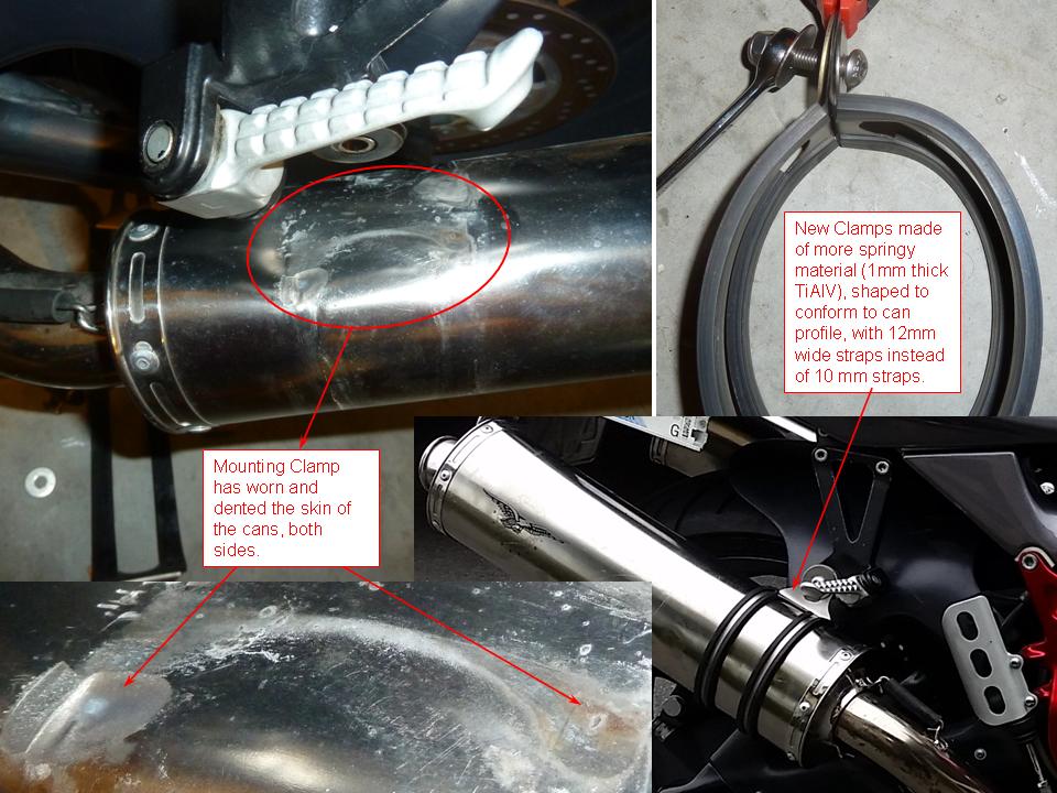

MartyNZ Posted March 13, 2016 Posted March 13, 2016 Did I just snag the last new titanium exhaust kit ever?! -Keith Great looking mufflers! My bike has a set fitted by a previous owner, and I like the style, sound and performance. But you might be interested to know that the skin of the mufflers is thin and soft. They will dent if you frown at them. You may want to check the fit of the clamps before too long. When I got my bike, one of the mounting clamps had fallen off, and was missing. It scratched the plastic mudguard as it departed. Looking at the clamp locations on both mufflers, I could see that the Titanium Kit clamps had splayed open, and so the bends pressed onto the muffler skin. This dented and wore the mufflers almost all the way through under the clamps at the top. I decided to make a new clamp, as no-one seemed to have parts for this kit. Then I couldn't find a source of the 10mm rubber extrusion that protects the muffler from damage (it doesn't do a very good job). I found some 12 mm rubber, so I made a pair of clamps with wider straps. I used EPDM rubber extrusion as the surface of these glasspack mufflers seems to stay cool (ish), and I made the clamps from 1mm thick titanium/aluminium/vanadium alloy. The clamps have some springyness to allow the cans to move without denting more. I bolted the clamps using new nylock nuts, so they won't fall off like one of the the originals did. This coming winter I'm going to try the repair suggested by waspp http://www.v11lemans.com/forums/index.php?showtopic=13524&hl=titanium I hope that this helps you to keep your Titanio Kit Mufflers looking nice. Marty 1
Scud Posted March 13, 2016 Posted March 13, 2016 Marty - I had a similar problem with the kit mounted by the PO, although mine were in much worse condition and had been shortened by a few inches. Those are great-looking straps and appear to be an improvement over the ones provided with the kit. I notice that you even cut the rubber bits so they would extend all the way to the junction of the metal straps, which should prevent further wear into the titanium skin. I have a new Ti kit awaiting installation. What would it take for you to make another set of clamps? Feel free to switch over to private message if you want.
