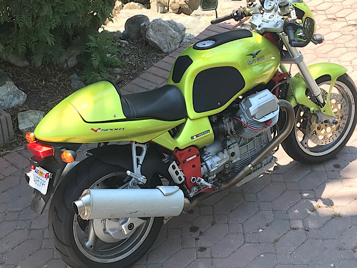

Kane Posted June 27, 2020 Posted June 27, 2020 Taking a tip from 4corsa’s earlier post, I put a set of TechSpec tank grips on the Greenie today. As pointed out by Phil in that earlier post, an opaque tank protector will show uneven paint fade over time when removed, but these sound like they work well and I’m curious to try. I’m not sure how I feel about the center piece. I may take that piece off and replace with clear. Anyway, here is what a Greenie looks like with slabs of rubber of her tank: 6

Randy Posted July 3, 2020 Posted July 3, 2020 On 6/27/2020 at 9:30 PM, Kane said: Taking a tip from 4corsa’s earlier post, I put a set of TechSpec tank grips on the Greenie today. As pointed out by Phil in that earlier post, an opaque tank protector will show uneven paint fade over time when removed, but these sound like they work well and I’m curious to try. I’m not sure how I feel about the center piece. I may take that piece off and replace with clear. Anyway, here is what a Greenie looks like with slabs of rubber of her tank: Expand Which ones are those? I looked all over their site for Guzzi ones but they didn't list any.
Kane Posted July 3, 2020 Posted July 3, 2020 Hi Randy, they don’t list the Moto Guzzi V11 on the website, but they have a templet for it on file, at least for my model 2001. They made them for me the same day and I received them in two days. They were nice enough to add a center tank protector for an additional $5. The ones I have are made from their Snake Skin material. Give them a call and tell them the year and model and they’ll help you: www.techspec-usa.com Ph: 775-783-5110 Good luck! 1

al_roethlisberger Posted July 5, 2020 Posted July 5, 2020 On 6/27/2020 at 9:30 PM, Kane said: Taking a tip from 4corsa’s earlier post, I put a set of TechSpec tank grips on the Greenie today. As pointed out by Phil in that earlier post, an opaque tank protector will show uneven paint fade over time when removed, but these sound like they work well and I’m curious to try. I’m not sure how I feel about the center piece. I may take that piece off and replace with clear. Anyway, here is what a Greenie looks like with slabs of rubber of her tank: Expand Those look especially good coordinated on the earlier chin pad tanks. I don't need a lot of extra tank "grip", but one oddity with the V11 Sport/LeMans tank and my physique is that the flare of the tank on it's slab sides tends to put a lot of painful pressure on the bony prominence inside of my knees which hurts after a while. So I may have to look into these.
