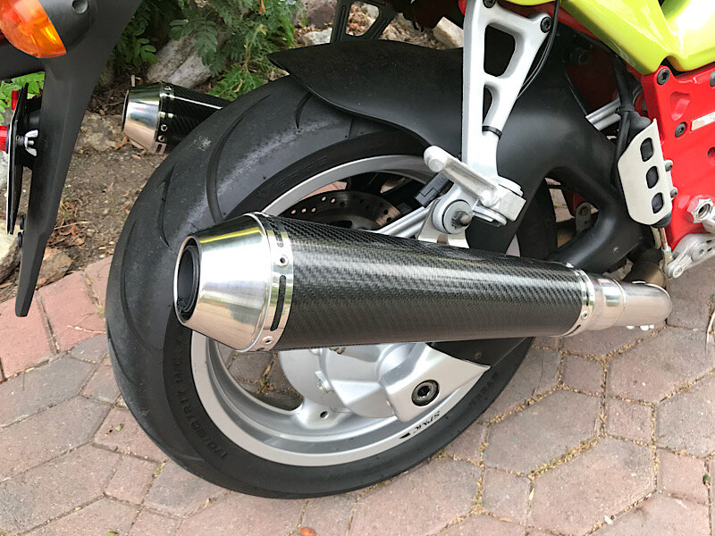

Kane Posted August 19, 2020 Posted August 19, 2020 Changed out the stock mufflers for these nice Mistrals. These have a bit more rumble and pop than the stock mufflers. I really like the sound of the stock pipes, a rich deep tenor and smoother than these. These are more open sounding, and they suit the V11’s rough and rowdy ways very well. The bike seems to like it, she’s running with a good spirit, like riding a Mustang horse if-ya-know-whadda-mean! Also: the stock mufflers weigh 9.89 lb each, total pair is 19.78 lb. These Mistral conical carbon fiber mufflers weigh 4.65 lb each, total pair is 9.3 lbs. 9

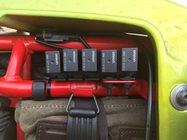

Kane Posted August 31, 2020 Posted August 31, 2020 Replaced the mix of Chinese relays that were in the bike with new U.S. made OMRONs. The OMRON relays are no longer made, but there are still about 2500 available from onlinecomponents.com (https://www.onlinecomponents.com/omron-electronics/g8he1c7trdc12-42670683.html Thanks docc!) One thing that I discovered is a suspect socket in position #4 (counting from front to back). If I wiggle the #4 relay the fuel pump goes on and off. I suspect that this has been like this for a while, and I’ve never had a problem, but I think I’ll pull and check out the relay base. 3
LowRyter Posted August 31, 2020 Posted August 31, 2020 1 hour ago, Kane said: Replaced the mix of Chinese relays that were in the bike with new U.S. made OMRONs. The OMRON relays are no longer made, but there are still about 2500 available from onlinecomponents.com (https://www.onlinecomponents.com/omron-electronics/g8he1c7trdc12-42670683.html Thanks docc!) One thing that I discovered is a suspect socket in position #4 (counting from front to back). If I wiggle the #4 relay the fuel pump goes on and off. I suspect that this has been like this for a while, and I’ve never had a problem, but I think I’ll pull and check out the relay base. I'd confirm that your diagnosis about #4 socket is correct given my Greenie experience. Wiggle it, spray some contact cleaner, play musical chairs with the relays. If you're religious, prayer might work. 1
gstallons Posted August 31, 2020 Posted August 31, 2020 2 hours ago, Kane said: Replaced the mix of Chinese relays that were in the bike with new U.S. made OMRONs. The OMRON relays are no longer made, but there are still about 2500 available from onlinecomponents.com (https://www.onlinecomponents.com/omron-electronics/g8he1c7trdc12-42670683.html Thanks docc!) One thing that I discovered is a suspect socket in position #4 (counting from front to back). If I wiggle the #4 relay the fuel pump goes on and off. I suspect that this has been like this for a while, and I’ve never had a problem, but I think I’ll pull and check out the relay base. You may have a problem with the wiring connectors in each socket . You should remove each connector and tighten each one . 1 1

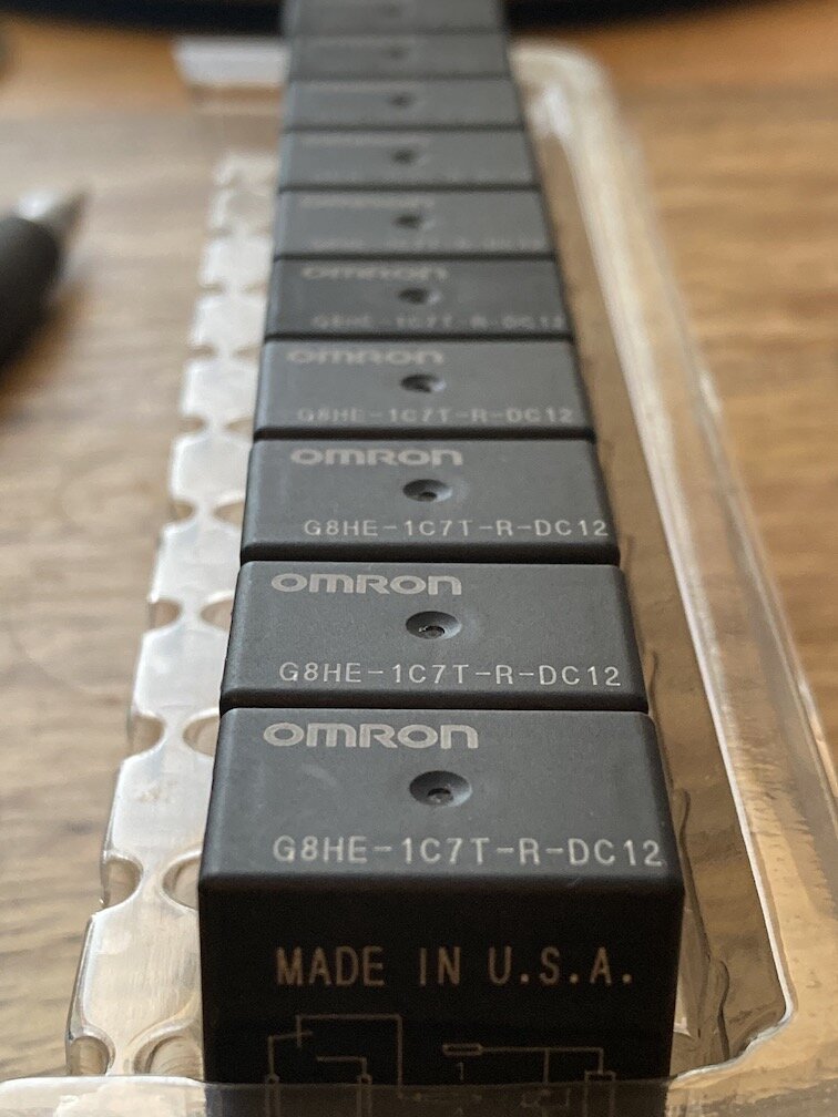

jtucker Posted September 8, 2020 Posted September 8, 2020 Finally drank the relay Kool-Aid. I've decided to hold onto all 10, though, as I like the idea of having spares on-hand, and eventually doing pre-emptive replacements at some point down the road. __Jason 3 1
sunbeamtim Posted September 18, 2020 Posted September 18, 2020 New battery, new fuel pump, new relays, first ride, second ride, third ride. Funnily enough, relevant to posts above, took advice off here to buy omrons, and tried to start it with new fuel pump before I put them in. Could hear bosch relay clicking away, but pump not working put new ones in and all peachy. Took a while to clear injectors out, but a tank full of clean gas and some gentle throttle and it soon cleared up to steady tickover and smooth running thru the rev range, after about ten minutes all the stutters gone. Was going to put it away as paperwork etc, but it was such a nice night I had to take another spin to make sure clean fuel thru, then thought I should take it out again just to make sure. First impression, surprisingly flat at low revs, but stonking over 5k. Rolling chassis is gorgeous, quite shocked I am, at least the gear change is kind of notchy going into first to remind me what I am riding. Reckon the Cali is going to be getting jealous. 4
