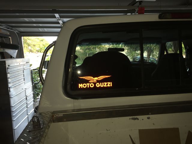

Scud Posted May 13, 2016 Author Posted May 13, 2016 Today I marked the Guzzi-spot in the truck for family road trips. Found the stickers on Amazon, these (two separate stickers) are Red-Reflective. Flash-photography permitted. 1
