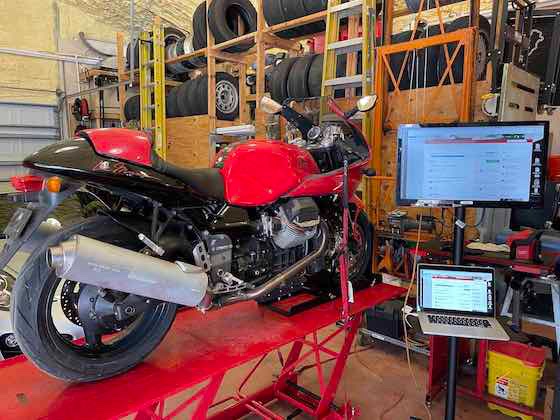

cwr Posted January 31, 2021 Posted January 31, 2021 Pulled the K75S I was working on off the lift and put the V11 on the lift. New battery, air filter, and plugs today. Replaced the one blown fuse and put some extra fuses in the tool bag. Heading to the auto parts store tomorrow for a section of hose to replace the one attached to the fuel vapors blow by pipe. Also looks like I need to replace the headlight bulb as well. Making progress. :-) 4
