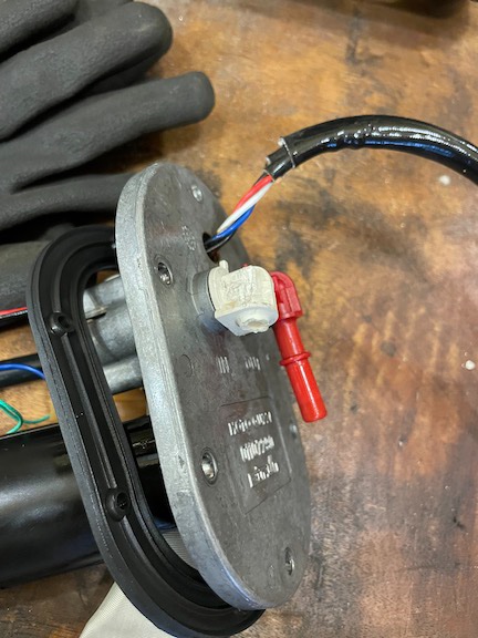

cwr Posted February 8, 2021 Posted February 8, 2021 UGH...went to start trying to figure out the electrical issue with the headlight, horn, brake light loop. I was unable to remove the fuel lines from the two nipples on the fuel pump assembly. I saw some videos that showed how to release them but no luck what-so-ever and didn't want to snap anything off. I resorted to lifting up the tank to get a visual on the connectors and "pop"...snapped fuel delivery D nipple on the fuel pump assembly. I could then figure out what was going on and why both wouldn't release. The coupler was "stuck" on each and wouldn't allow the "barbs" to move thus becoming one with the nipple. Was able to finally get the other fuel line off of fuel delivery C nipple and remove the tank inspect the electrical connections. All look well so time to break out the electrical diagrams and figure out what's up. Already have a new nipple from MG Cycles on its way and the couplers now move freely and this shouldn't be a problem in the future. :-)
